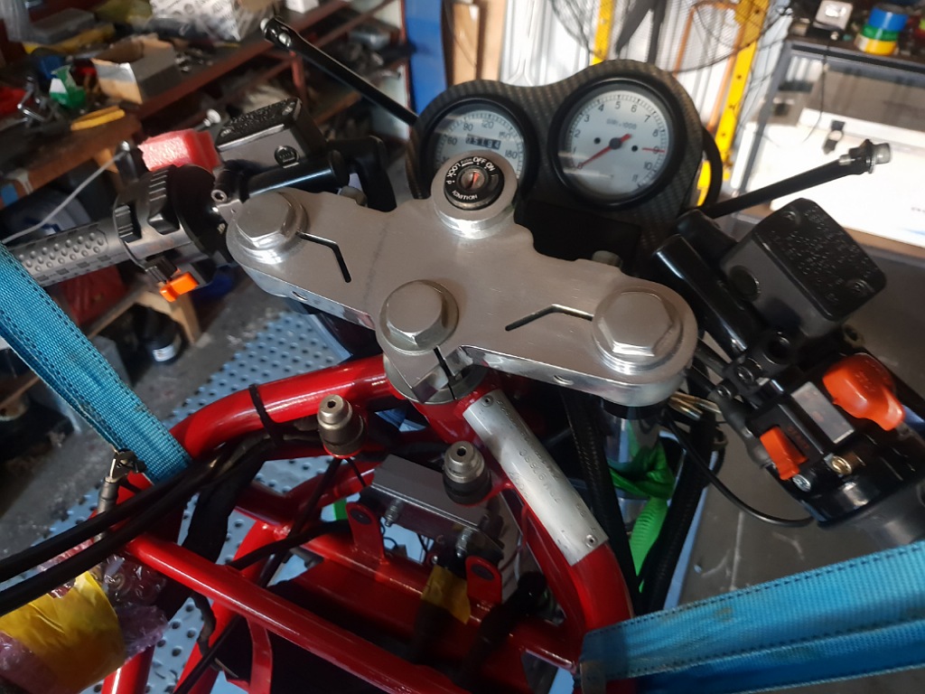

by Kmamac
Hopefully photo attached. Those more wise on such matters will tell us if the top is standard or part of the maxton upgrade
Re: Fork upgrade 40mm MR1BB
Posted: Mon Feb 10, 2020 10:27 am
by bbeen71
Thats different from my top cap, but also different from the top cap on the kits they sell now I think.

by HIGHWAY89
Better late than never, I think and hope this is the original topnuts for the standard forks on the 89/90 900 SUPERSPORT, I've rebuilt these but not had the chance to see how they work
