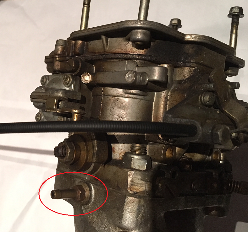

The take off screws can be screwed in at each side of the inlet manifold, so not in the carburetor itself. My carb is a DCNF 44-107 by the way. See pictures. I started with adjusting the idle mixture screws so that the engine would idle at 1000-1100 rpm. Then I connected my vacuum gauge, restarted the engine and looked whether the water level in the bottles changed. Naturally it did, indicating the carbs were not synchronized. So then I adjusted the two air balance screws in small turns until the water level in the two bottles stayed constant. With this the engine is running more or the less OK. Below 3000 rpm with a cold engine it's quite terrible, as we all know. Once the engine gets warm, it's a lot better, but not perfect. Above 3000 rpm it's running well. I guess it's the maximum I can get out of the Weber without major set up changes.
By the way, it's (virtually) impossible to perform this operation with your fuel tank installed. Therefore I made a temporary project fuel tank out of an old lense fluid container :) See last picture.
Good luck!
Weber 44 DCNF 107 - pic 3 - RH side.png (994.03 KiB) Viewed 20537 times
