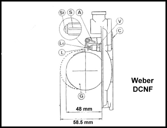

Any advise on which float level I should use: 42 or 46mm?
Good tip: Guzzi dealer!

Re: Weber 44DCNF - idle air jet ???
yes, P750 46mm, 906 42mmThe float level confused me a little: the Paso 750 workshop manual says 46mm but I read a lot about 42mm (maybe for the 906 .... ?).![]()
Higgy, thanks I'll adjust the float to be level with the top of the carb.
Makes sence because if not level my next question would be which part of the float should be 46mm from the top.
If I adjust it level with the top it measures 42mm, so I will keep it there.
That's simple. See pic below. Ignore the 48mm that is for the metal floater not the plastic version. The float level is measured as shown or with the cover at an angle. It's usually not measured upside down because the weight of the floater could aready bend the tongue and falsify the measurement.my next question would be which part of the float should be 46mm from the top
Imo 42mm is too high. You risk the carb to overflow and the engine to run even richer.
