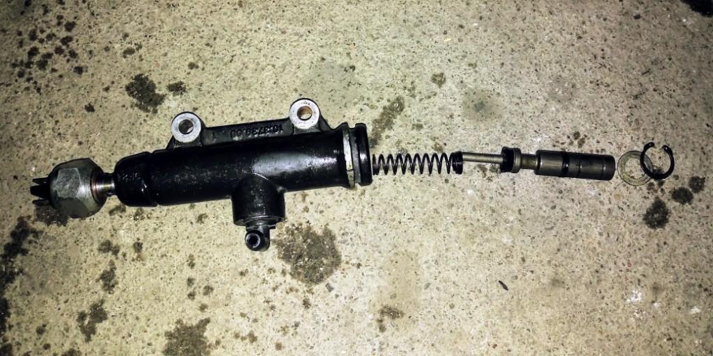

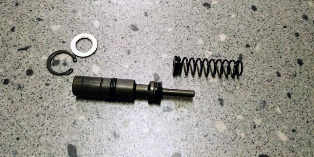

Hi, can you tell me which rear brake pump would fit the 906 Paso?
I wanted to rebuild only the piston, but I have not got anywhere in the EU, I will probably have to replace the whole brake pump
Rear brake pump

Rear brake pump
- 20180425_101800.jpg (104.67 KiB) Viewed 12611 times
- 20180424_145913.jpg (120.61 KiB) Viewed 12611 times

Brembo seals and repair kits can be bought from KTM dealerships. Make sure that the model has the same master cylinder.

my piston is 11mm and they do not have a supply

you can still find the complete pump.

Re: Rear brake pump
it will be it, thank you

For information. Repair kits for the Brembo PS11 rear master cylinder (and many more) are available from Gutsibits in the UK.

Re: Rear brake pump
I ordered here, thank you for the tip
https://www.stein-dinse.biz/Ducati/Brem ... 16254.html
I have a mounted brake and it works as it should
