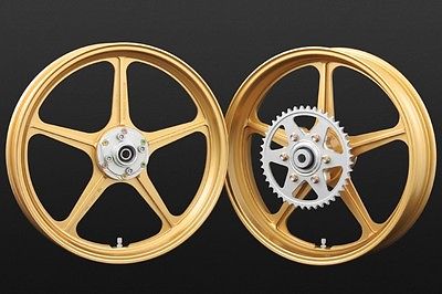

I've also got a 1984 Bimota SB4 S.
it had 16" magnesium Campagnolo wheels which are not safe to use anymore due to advanced corrosion (never magnesium again). :-(
Now I'm looking for similar styled aluminium replacements wheels (16” x 3,25” front and 16” x 4,25” rear).
See pic.
I’ve tried almost everything to find me these wheels but unfortunately: with little success.
PVM in Germany where willing to make me a set of 16” wheels but asked – sit down first – : € 10.000 (excl. 20% VAT).
Well, I assume it will cost me but not € 12.000 !!! :wacko:
Does someone has an idea how to get a set of 16” aluminium 5-spoke Campagnolo style wheels?
Is there not a company able to make them from billet (aircraft quality)? :?:
I’ve even made drawings of the hubs (al dimensions) assuming they will need them in order to be able to produce me a pair.
