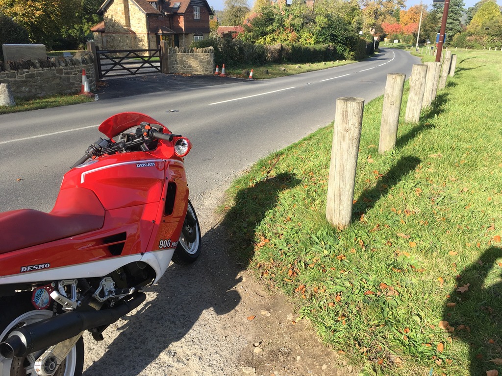

Well after a few months I have finally got the 906 fixed, MOT'ed and taxed. Another one back on the road. I took her out for a couple of hours into the countryside and a most pleasant ride was experienced.
I had to take it very easy on the corners as it still has the 10+ year old tyres on it. (Just about to order some new rubber).
Having being spoilt by 150 bhp of the multistrada I had forgotten how the 2 valves produce a smooth torque rich experience from low down all the way to the red line. No explosive end of tacho experience but it was very nice to leave it in a gear and let the engine pull it out of corners. Also nice to rediscover the 'joy of thrashing' so to speak. Do that in a couple of gears on a modern 150 bhp bike and you can be in a hedge pretty quickly!!
The cont 2:1 is an absolute joy and really adds to the whole experience. Only little quibble was when I drove out of London through the traffic. When going from zero throttle to say a couple of degrees of throttle turn, it was a little bit snatchy. Nothing massive and to be honest I can live with it, if that's the best it can be. However, if fixable I would like to fix it. I do have a little oil leak from somewhere at the rear of the engine but to be honest I will live with this for a good few months- time to enjoy her for now.
Totally impressed at how modern the suspension is. After jumping off a skyhook multistrada one would expect the paso to feel a bit agricultural. Absolutely not - very impressed. On the comfort front I went from a 999s to a multistrada as the wrist thing was becoming a pain. A bit worried I may be going back into this arena of pain with the paso but none of it. Really pleased, two hours racing about the back lanes and no discomfort.
The 16 inch experience? Well I still have the memory of being in my 20's and getting a corner spectacularly wrong and having to slam the anchors on mid corner and being freaked out by the way the paso sat up. Today I was reassured that with 'non emergency' behaviour the 16" wheels felt absolutely fine. I was very reassured and pleased with how she behaved. We all know with hindsight 17" seems to be the optimum size for road bikes but I suspect some people have made a bit of an over amplified fuss about it.
All in all very impressed and overjoyed I have rediscovered the love of the paso after 26 years- I did not realise what a lucky 20 something boy I was at the time.
