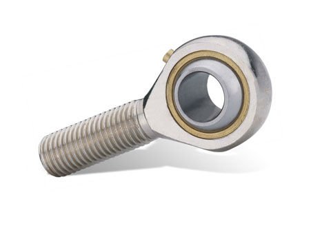

usually bore size and thread are the same but they also exist in versions with smaller bore and larger thread.
So male rod end bearings with 8mm bore and M10 thread exist but the opposite is what I`d need.
Do these exist? I couldn`t find any.
male rod end bearings w/ M8 and 10mm bore?

so you are looking for an M10x1.5 with a 10mm bore ?
or an M8 with a 10mm bore ?
also right or left threaded ?
Re: male rod end bearings w/ M8 and 10mm bore?
I`m looking for M8 (right) thread and 10mm bore

thanks Steve & Gert but all I find there are rod end bearings that have the same thread diameter & bore.
Really seems 10mm bore with M8 thread does not exist. I`ll check shops that sell kart sport parts now.
