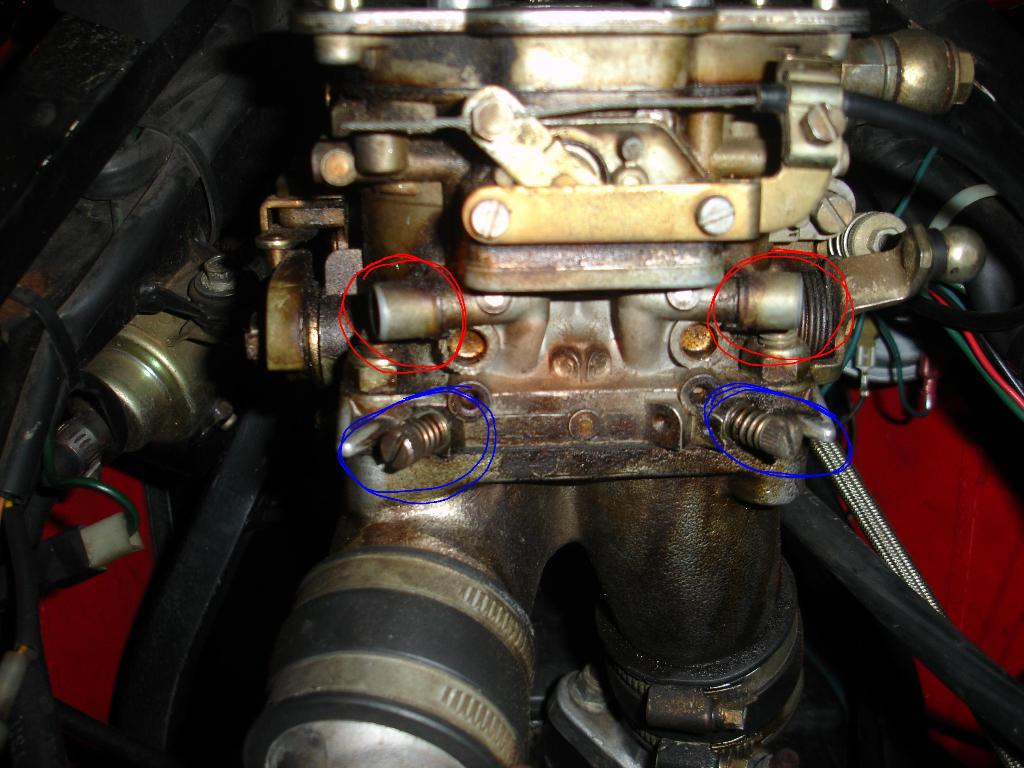

I'm in (Weber) carb hell on the 88 750.....how many turns should the air and fuel screws be turned out? Also - forgive my stupidity but which one is what? You have one on the upper (when looking at the carb) part of the carb then another on the lower part. Is the lower the fuel and the upper the air?

I think the lower screws are for the idle mix and the upper ones are the air balance screws . The balance screws are to equalise air flow in the two barrels and one of them should be closed ( the highest flowing barrel ) and the other open enough to even the flow . You really need a set of vacuum gauges to set the balance and the idle mix screws should be set to get max vacuum and then open 1/8 turn ( ish ) Don't be surprized if the two mix screws need to be set slightly different and the cam timing one these bikes is known ( sometimes ) to differ between cylinders by up to 8 deg , and this is something you should at least inspect if your trying to get a really good tune job...... bit of stuffing about but you only need to do it once ( there are guides in the tech section ... Higgy and Romus did a really good tutorial , Paso cam timing , which sure is worth a look .
dcnf44_back _view.JPG (112.61 KiB) Viewed 27437 times
Hopefully the attached image is visible - the screws circled in blue are the idle mixture screws, the areas circled in red are the idle air bypass screw housings (screws are recessed within).
Hope that helps!
Start with both bypass screws closed, and the mixture screws about 2.5 turns out. Get the engine started, if it won't idle, first open both mixture screws about 0.5 turns from initial setting, then try closing both mixture screws about 0.5 turns from original setting. Once you get the engine idling, slowly adjust one mixture screw at a time to get the highest idle rpm you can, then adjust the other mixture screw in the same way. Final adjustment is setting the idle speed screw to get about 1000 rpm idle speed.

jfiore wrote:
Hope that helps!
Yes and thank you! The issue I'm running into is that it's only running on one cylinder. It ran fine all last summer then towards the end of the season it drop a cylinder and would only run at wide open throttle. Checked spark, no issue, pulled the two jets out and blew them out with WD40 and air to make sure they were clean....ran fine for a few days then drops a cylinder again....backfiring through the exhaust and running like crap! I'll try what you've indicated and see what happens. Thanks for the help.

You may have accumulated some ethanol sludge in the float bowl, which can block the idle circuit, since the holes and passages are so small. Try removing the idle jets and carriers, and spraying carb cleaner through the openings. You may also try adding one of the popular fuel treatments for ethanol sludge to your fuel, it can't hurt.
It also wouldn't hurt to remove the top of the carb to check the float bowl for sludge, and at the same time check the float height (should be max of 46 mm) - a float that is set too high can result in a fuel level that allows non-emulsified fuel to spill through the secondary venturis, especially into the left carb barrel when the bike is on the side stand, which will choke that cyclinder (ask me how i know...)

Well I took everyone's advice and at least it's running on both cylinders now so thanks for all the help! With the temp only being in the mid to upper 30's I'll wait to take it for a ride and see if it runs at speed...but at least it's running :lol:
