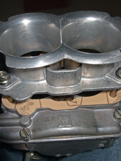

is that the right airhorn ? I`m just wondering as this is the original one (front and rear view) and it has those scoops on both sides ie for the starting jets. Yours has a completely closed bottom plate. Could that be for a sidedraft Weber instead ? I have no clue, just noticed the difference.

I'm not sure... it is listed for a DCNF.... don't think the ever side drafted one of those. I could be wrong though. I haven't bought it yet, but it looks like the next best thing to stock. I could notch that area if it covers any jets. I could also fab up that little "scoop" on both sides if necessary. I would prefer the stock piece but that search has proven difficult at best. higgy has one... but he won't be able to get to it for 6 months. I would kinda like to ride before December if you know what I mean.
Posts: 5570
Re: Weber 44 DCNF part help
DCNFs were downdraft.
This shop in Italy sells the right airhorn http://www.ricambisport.it/ing/ricambi_ ... 143&id=119
edit: considering the one from Pierce manifolds is $86.45 (+ shipping I guess) the total may be the same. (€50=$60.15) Don`t know what they charge for shipping to the US. They could put in an envelope/jiffy bag and send it as recommended letter which would be the cheapest but I don`t know if they do that.

That should be fine Jason.Identical to my setup as a matter of fact,except for the air horn.You should be able to drill some holes for the air correctors and chokes in that one if they havn't provided any ventilation.The spacer now looks identical and the air filter is the same dimensions. The above picture of the airhorn,illustrates the point that I made earlier about vacuum leaks.You can quite clearly see the tops of both the air correctors sitting in their ports,then on the airhorn you can see the vent that they should be breathing through.Now look closely at the gasket,or lack thereof,if you were to screw the airhorn down like this the air correctors would be under the influence of a vacuum source,and one of the biggest issues in tuning the weber is getting them working at low revs.The last thing you need near the top of their inlets is a vacuum source drawing air away from them.This is why the airbox base is important as it effectively cuts off any airflow back into the main chokes from the air corrector port,by slipping down inside the main choke a mm or 2.I will be putting a spot of sealant on mine during the final fit off.Don't put the air cleaner base on the carby first as it will do the same thing as the gasket is doing in above picture.First the black spacer (already trimmed for you,nice work !),then gasket,air cleaner base,air horn,tighten up nuts,then rest of air cleaner.If it is the K&N then there's enough room to fit the tank back on.

The difference in the airhorns, one is for Fiats and bikes the other is for Maseratti and Ferrari, and Lambo's

higgy wrote:The difference in the airhorns, one is for Fiats and bikes the other is for Maseratti and Ferrari, and Lambo's
So is this one the same as stock for the Duc? Image
I need to download a translator so I can read their web site.
Oh and by the way G. great find.... http://www.ricambisport.it/ing/ricambi_ ...143&id=119 .. looked everywhere so I thought..
Posts: 3380
yes, that is a picture of the standard Paso DCNF stack

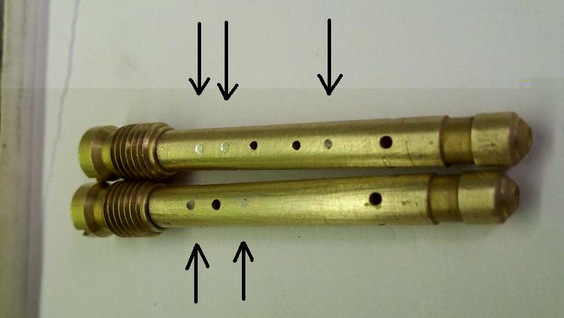

After following your tuning tread I checked all my jets. Idles 57, AC 170, Mains 150, Starting jet 110F7. And check out the tubes(incase pic doesn't come out right... arrows are the soldered closed holes).
filled holes.JPG (108.09 KiB) Viewed 15786 times
I ordered the airhorn from that place in Italy (man the American dollar is crap these days) and G. is sending me the airbox spacer. I still need to order the same jet setup you have.

Hi Jason,G is right your aircleaner/exhaust setup will affect the jetting as will,climate and elevation,which from a previous post of yours would appear to be very similar to where I live,your aircleaner setup is the same,the only thing that is unclear is your exhaust system.I have conti race cans on mine,so it will tend to run leaner than stock.
Anyway regardless of your exhaust,I would get a set of 55 idles and perhaps a set of 54's just in case and stand by for an update on the pump cam.This will fix 75 % of your problems
if your impatient like me you could also get a set of larger air correctors 185,works ok.and a couple of sizes of mains 160,165 or 170 which I am currently using but are a tad rich.
Or.... you could just wait and see how the pump cam changes everything
As a matter of fact,I think that I would be putting it back together as is ,without the pump cam fitted and seeing if this sorts out some of your problems before I ordered anything else.
you have to undo the 4 screws on the pump diaphragm to get the cam off the shaft,and use a small spanner on the end of the shaft to hold it while you undo the securing nut,otherwise you could bend the throttle shaft and put the butterflies out of alignment,so be carefull with it.You can then gently prise it of the shaft with a thin screwdriver,going from side to side so as not to break anything
As you have the 10 cam fitted I would expect you to find an immediate improvement in low speed operation,and then it will probably go flat from about 1/3rd throttle while accelerating,this is to be expected,and this is where your cam needs to start pumping,not stop (as it currently does).
As for your frankenstein emulsion tubes well I wouldn't be too concerned just yet,but for your curiosity here's my setup.
Starting from the top side of the little step that the air corrector slips down to and measuring down the tube (the join line between the emulsion tube and air corrector in your photo)
my rows of holes measure as follows.
(lower side of step tube outside diameter 4.7 mm)
13.5 mm to centre of holes,4 holes @ .8 mm
(14.5 mm the diameter of my tube increases by 1mm at this point to 5.7 mm)
15.5 mm to centre of holes,4 holes @ 1.0 mm
20.0 mm to centre of holes,2 holes @ 1.0 mm
As I said don't be concerned with your tubes until you get everything else sorted.You probably won't end up touching them,I placed a lot of emphasis on them ,when I should have been looking at the pump cam instead. :banghead:
I now think that time spent developing a 'Paso profile cam' is going to be time better spent. Jay.
