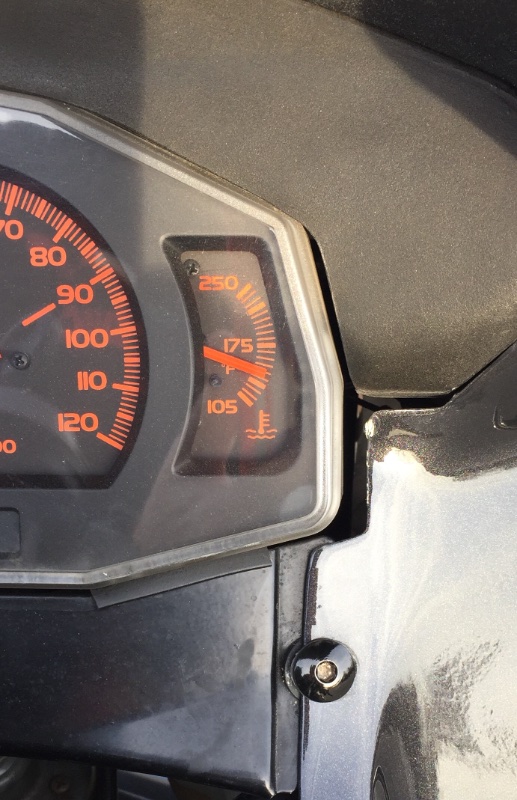

Posted: Thu Jan 05, 2023 4:20 am
by Janky59
As I get more seat time with my recently purchased ‘92 907ie I’ve been wondering if my coolant temperature is “normal”. This time of year I’m riding in air temperatures that are give or take 60 deg F.
The pic is from the bike a couple days ago right after a moderate backroad ride, this is a pretty typical gauge reading I see, it seems to be running about 150F or 65C. This seems a bit on the low side to me, but I guess there’s nothing really to do about it. It runs good so I don’t have any complaints.
When doing in town, stop & go sort of traffic the gauge does go a few ticks above the 175F mark, so the gauge and temp sensor seem to be in working order.
No real question, just posting up a data point. Cheers.
