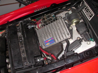

(A) Early I- The first is found on F750 and early 906 the solenoid is under the seat as shown above but the positive battery terminal is on the right side of the tray.
The positive lead will be long enough to reach the right front of the battery. If your battery post is at the rear there will be about 75 mm of slack but there is plenty of room to dress it out of the way.
(B) Early II - as shown above, with the positive terminal on left side of the bike.
The positive lead will be long enough to reach the left front of the battery. If your battery post is at the rear there will be about 75 mm of slack but there is plenty of room to dress it out of the way.

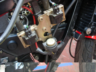

(C) Middle - most 906 and some early 907 the solenoid is about 5 inches higher/closer to the battery than shown in the photo for the late series below.
(D) Late - most 907 the solenoid is way down on the front as shown below.
