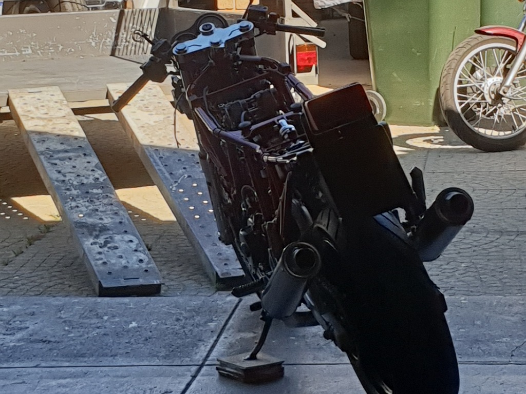

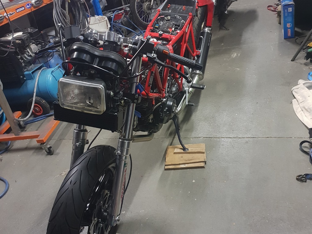

First outing in a while, you beauty off to protwin tomoz, yeeha

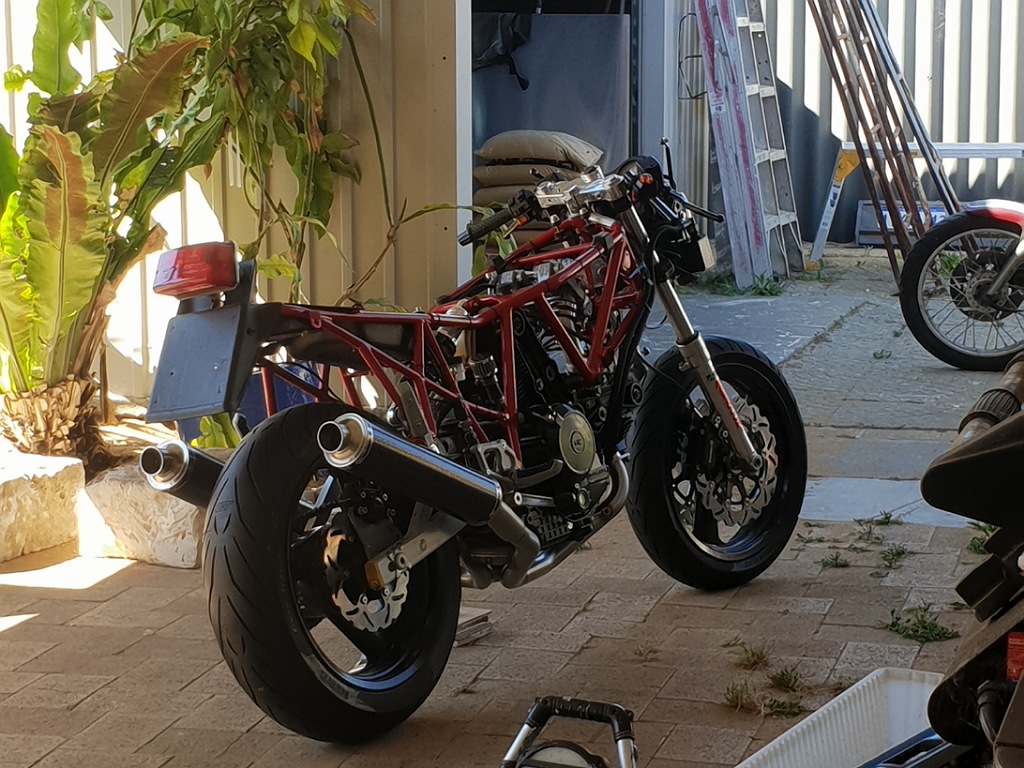

Posted: Mon Dec 02, 2019 6:14 pm
by paso750
The bike is getting better and better :thumbup:
Interesting that the thread pattern of the front and rear tire is reversed.

Yeah I know, but its correct according to rotation marks,a few have mentioned it, may be start up this week bar the paintwork

paso750 wrote:The bike is getting better and better :thumbup:
That seems to be normal with most modern tyres I think it may be because the maximum traction forces are reversed - braking for the front, accelerating for the rear.

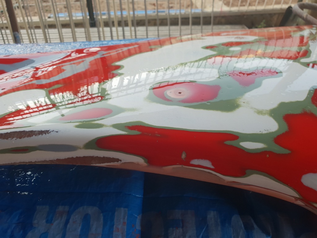

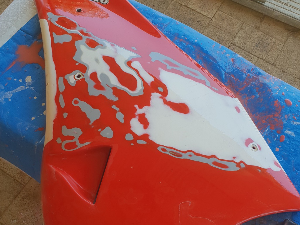

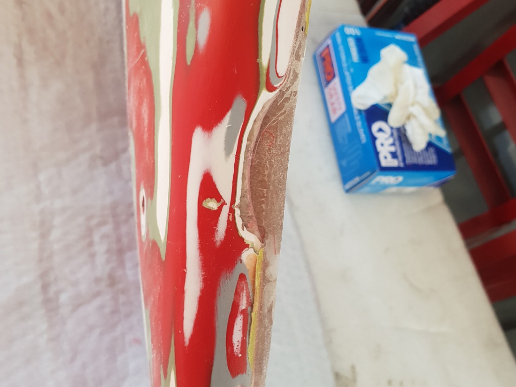

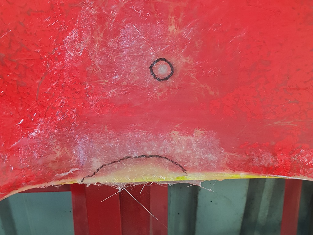

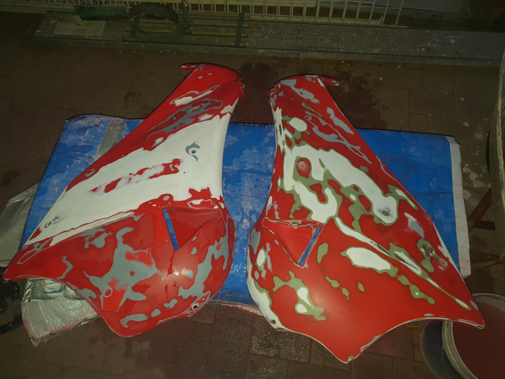

Just starting the paint preparation process as I know it, 240 wet/ dry to remove clearcoat,decals, in the case of the fairings now I'm removing the white over a full coat of red then the red to end up with mainly grey/ originally primer, on fibreglass, careful not to expose fibres as they are later hard to get rid of, then some fiberglass repair/ strengthening on the back of panels and finish with car filla on the finish side, I've been standing this panel for a good hour and a long way to go

Lots of block sanding with 240 wetdry, good few hours work, I used the orbital on the right side fairing which made it easier getting the clear coat and old decals off, those 2 panels are nearly ready to prime, just need to plug away , hope to pick the bike up from the shop tomoz, also the decals, happy days
