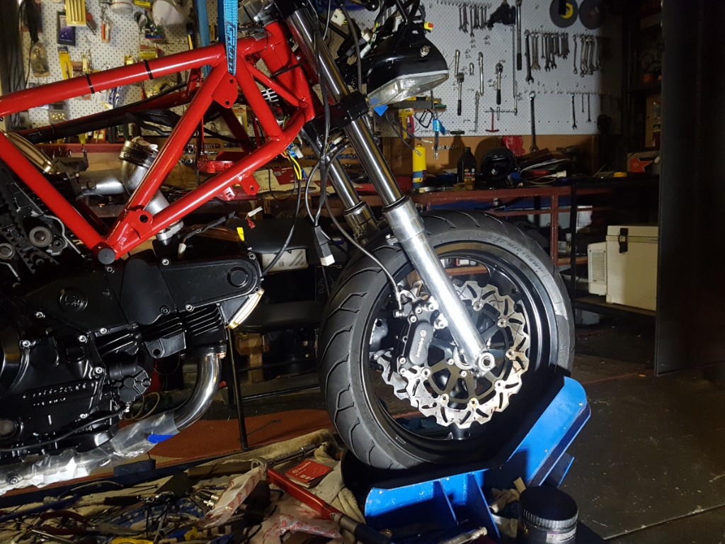

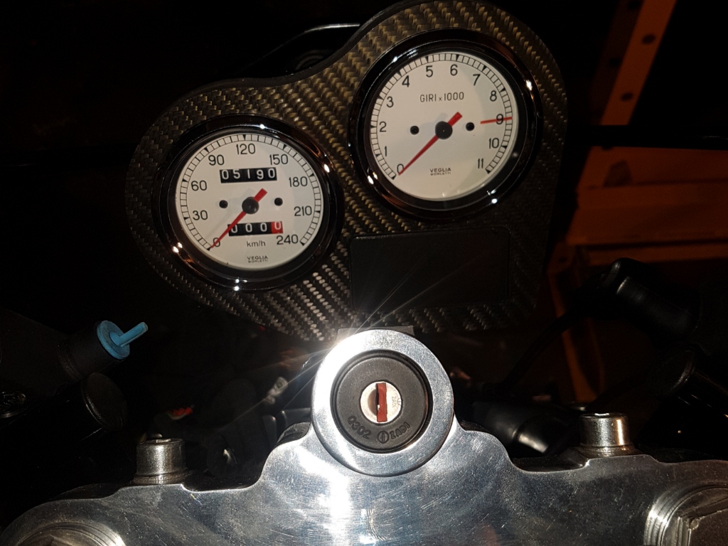

Post by HIGHWAY89 »
Speedo and rev counter in for a quote to restore / glass and bezel , fingers crossed for a good price and job, frt wheel and brakes back on and the left disc bolts countersink 3mm, so she's progressing but slowly

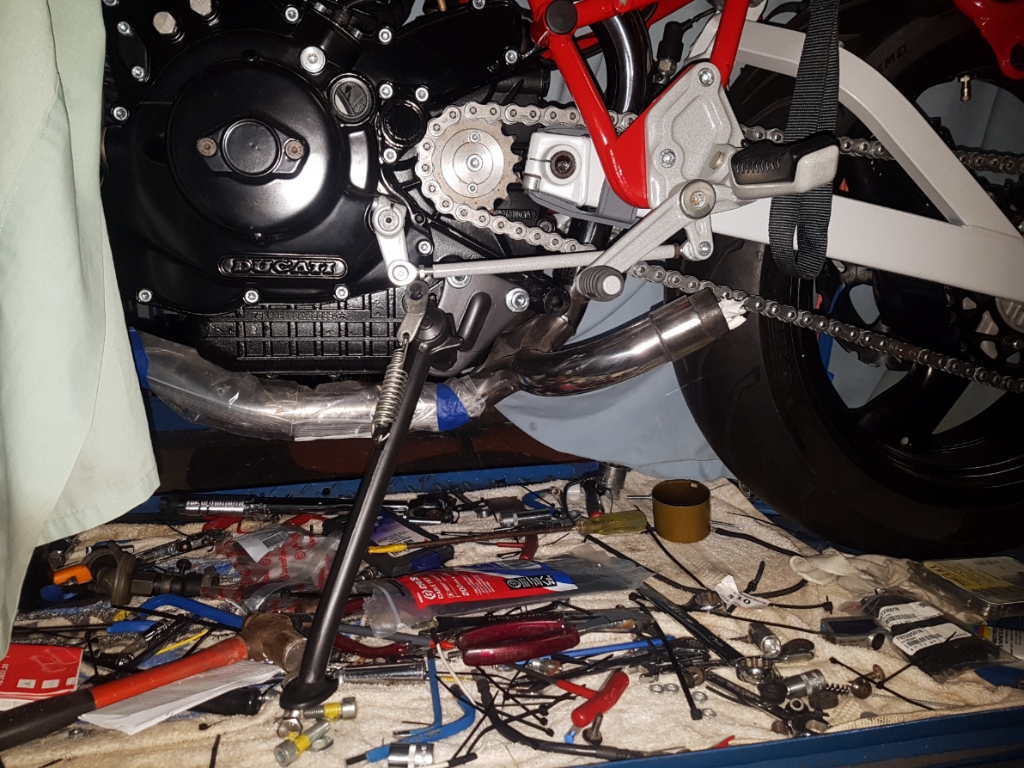

No good at instrument shop , anyway I've ordered some chrome bezels / glass cheap and get shop to crimp if they're right. Got a longer stand and finally paint and put together with replated springs etc, waiting on the bezels, also ebay a restorable condition rear lens and housing as mine knackered, and nos Speedo drive turned up with a split in the housing same as mine , but not ground down like mine and it clears the countersunk rotor screws, so goodo
MatthiB
Posts: 12
Joined: Sun Dec 31, 2017 8:35 am
Location: Germany
Re: Oil leaks 89 900 ss
Post by MatthiB »
Still doing an excellent job! :thumbup:
May I ask where you took the longer sidestand from and what sprocket fixation bit that is?
Thanks for that and for letting us follow you work!
HIGHWAY89
Posts: 637
Post by HIGHWAY89 »
To be honest I don't know which model the sidestand is off , when I got from ebay I thought it was the same as original but it turned up being longer which is great although I haven't had the bike on the ground yet to check, the cap on the end of the countershaft was made by protwin ducati to compensate for a slightly worn spline so I didn't split the engine and replace the shaft
MatthiB
Posts: 12
Location: Germany
Post by MatthiB »
HIGHWAY89 wrote:To be honest I don't know which model the sidestand is off , when I got from ebay I thought it was the same as original but it turned up being longer which is great although I haven't had the bike on the ground yet to check, the cap on the end of the countershaft was made by protwin ducati to compensate for a slightly worn spline so I didn't split the engine and replace the shaft
Thanks! :thumbup:
Derek
Posts: 768
Post by Derek »
It looks like the stand from a 907 but I guess there are a number of other possibles.
