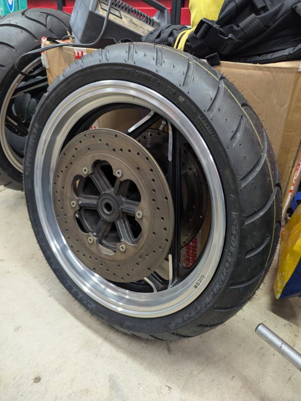

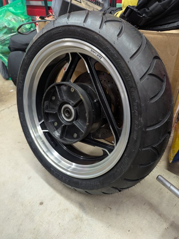

So it's been a while yes since I updated this. Not much has happened but... I did get new tires installed finally. I'll post later the date stamp but I can at least say they're just over two years old. Old yes but better than the 24yr old rubber that was on it. I'll scuff up the rotors lightly before I install the wheels and check out the brake pads also. Bike only has 14k on it so I'd imagine the pads are ok. I'll probably end up getting new ones just for condition sake. New chain will be here this weekend also, maybe install that if I feel so inclined.

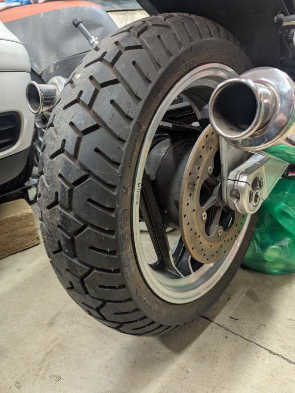

Something that I have been thinking of now that I have the tires off - change the gearing maybe. As you can see here, chain was last adjusted in the middle of the rotation. Gearing right now is 15/38 with a 106 link chain. Bought a 108 link chain just in case I felt like going up two teeth or so; plus the chain was only $93 and I got it sooner than a 106 link one. I see I can get a new rear sprocket on Ebay but... how badly do I really want it, I don't know. Time for more research...

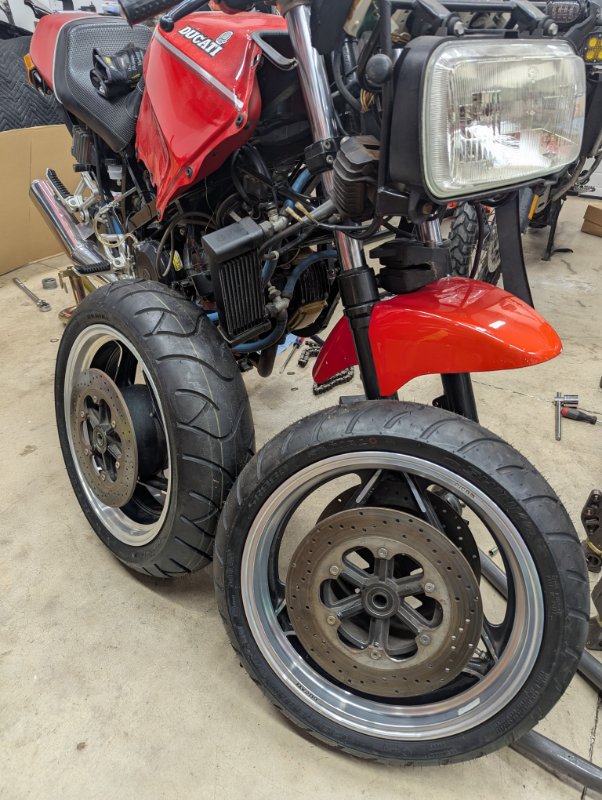

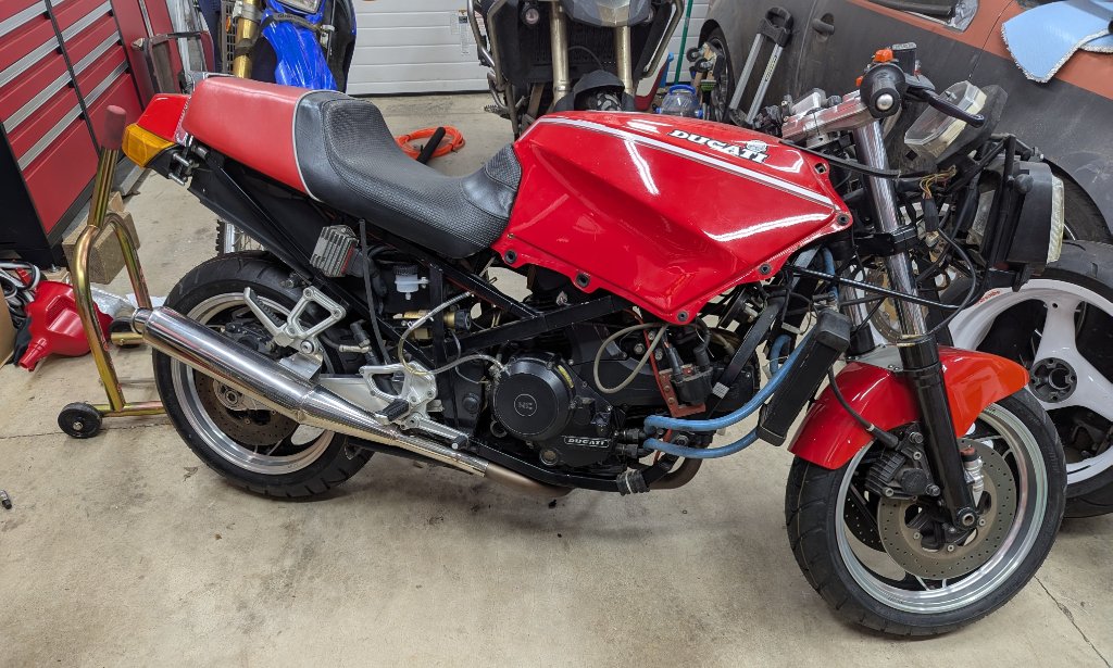

Here's the bike with fresh rubber now.
