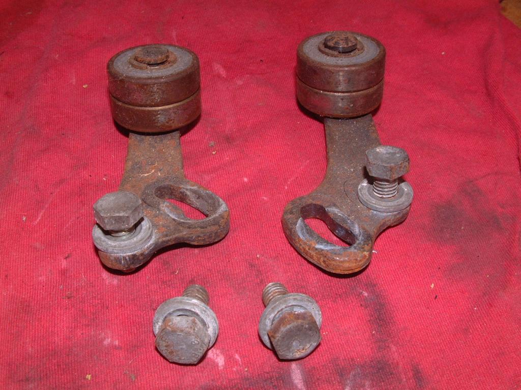

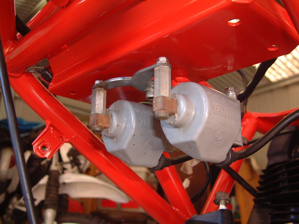

Ok,the horn is painted.It was blowing a gale here today and it shows in this crappy paint job.Never mind,no one will see it.

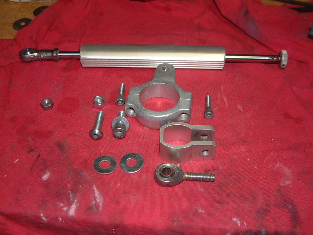

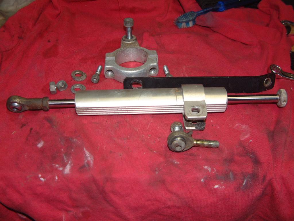

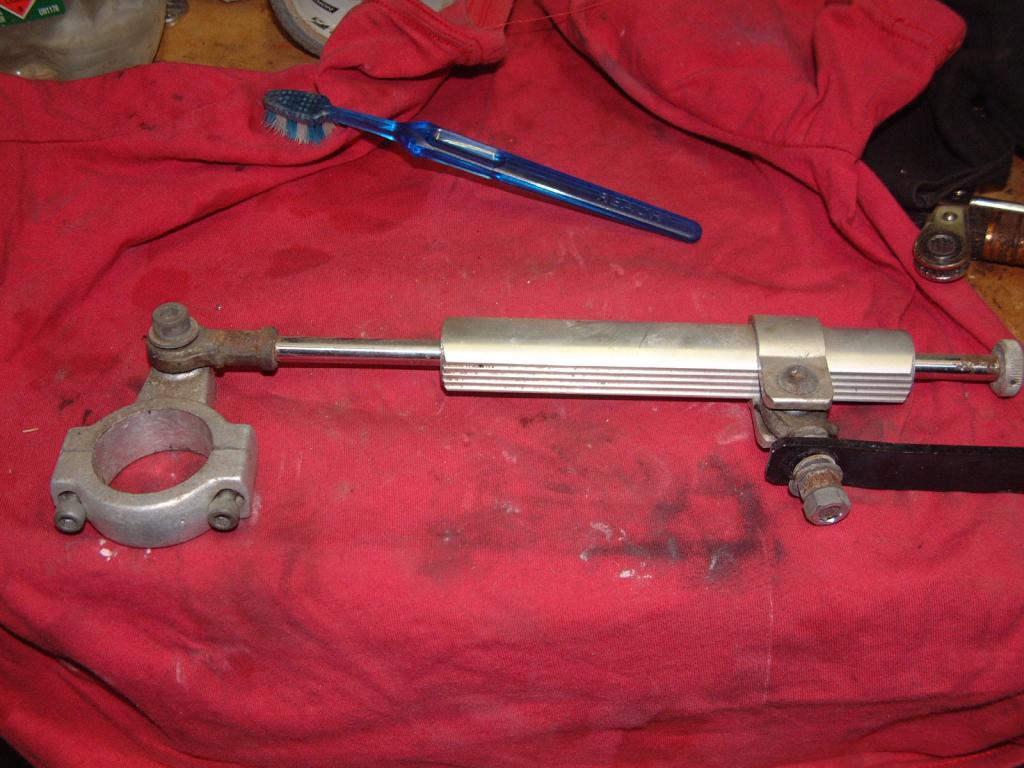

Next up the steering damper.

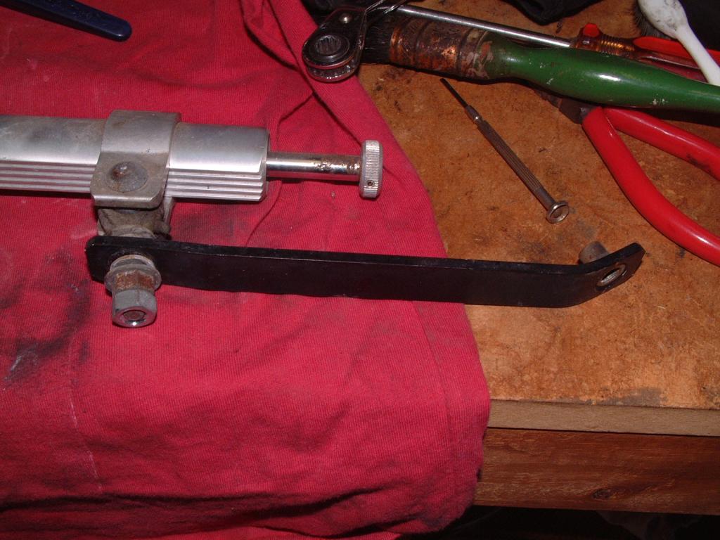

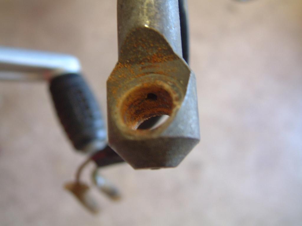

You can see the rust at the very end of the shaft.I'll remove as much as possible but I don't think it will effect the damper anyway.
I still have to look at the rust on the shaft but it's better...
...except this.

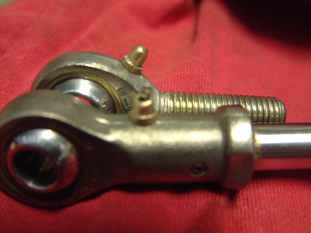

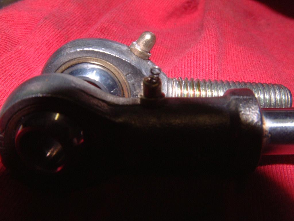

It's a bad photo but basically I got over excited with the wire brush and wore through the brass? cap and out pops a spring."So what does the spring do" and how can I repair it.A dab of solder ( not sure if solder would stick to brass ).Find another cap.I would'nt even know where to start looking for a cap.

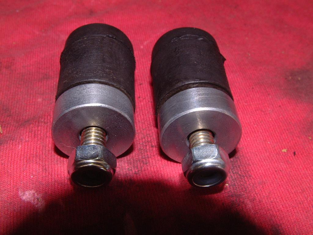

Next job is cleaning these.
I don't want to remove them so I'll have a crack with the dremel and wire brush tomorrow.

if there`s a spring there`s usually a tiny steel ball which is being pushed down by it.
- Posts: 574
Any idea what it's purpose is on the heim joint?paso750 wrote:if there`s a spring there`s usually a tiny steel ball which is being pushed down by it.

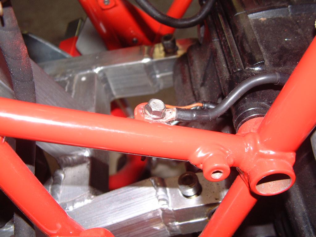

I have a question.What parts need to be grounded to the frame and what's the best way of going about it without wrecking paint on the frame?.

Solder will stick to brass no problem. Or you could tap a suitable thread in the hole (M4/3.5/3?) and fit a small grub screw to retain the spring.It's a bad photo but basically I got over excited with the wire brush and wore through the brass? cap and out pops a spring."So what does the spring do" and how can I repair it.A dab of solder ( not sure if solder would stick to brass ).Find another cap.I would'nt even know where to start looking for a cap.
- Posts: 574
G'day Derek,nice to hear from you.How's the 907 going?.Thanks for the advice.I'm still wondering what that spring is actually doing in there.There must be a reason but I can't seem to fing an answer.I might pop into the local engineer next week and ask him.It's got me intrigued now.Derek wrote:Solder will stick to brass no problem. Or you could tap a suitable thread in the hole (M4/3.5/3?) and fit a small grub screw to retain the spring.It's a bad photo but basically I got over excited with the wire brush and wore through the brass? cap and out pops a spring."So what does the spring do" and how can I repair it.A dab of solder ( not sure if solder would stick to brass ).Find another cap.I would'nt even know where to start looking for a cap.

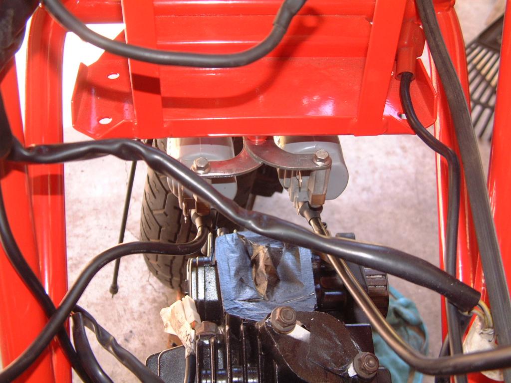

I started off by dragging the wiring through the frame..then back through the frame when I got it wrong...then back...never mind
[/url]
I forgot to take a photo of the wiring at the front but it's all back together.I'm not happy with the way it all gets jammed in there so I might pull it apart yet and try and neaten it up.

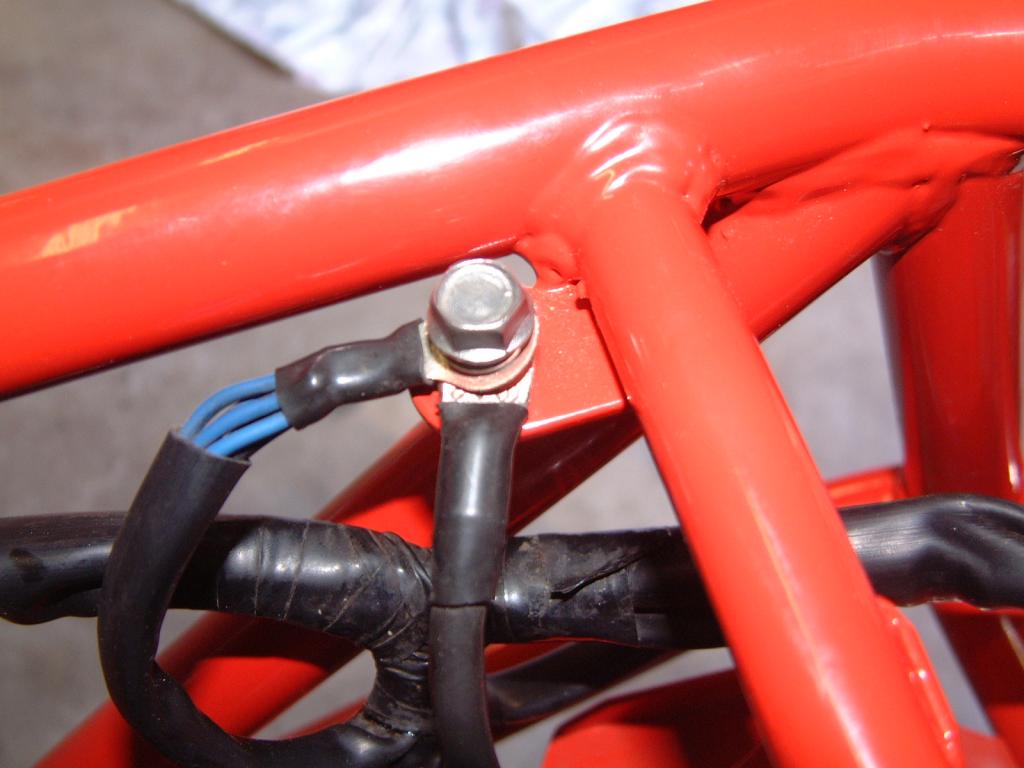

What next.I know I have to bare some paint on my frame for the earth but I'm really putting it off...I don't want to take any paint off
[/url]
I suppose it's got to be done.There,it's done....well one of them anyway.

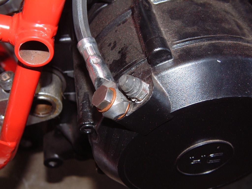

A couple of new copper washers and it's done.

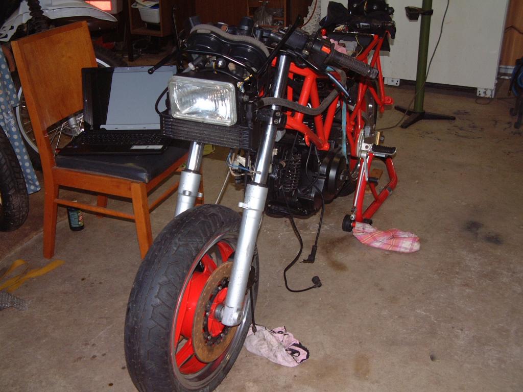

Where she up to now.For 5 hours work this arvo it does'nt look like I got much done.

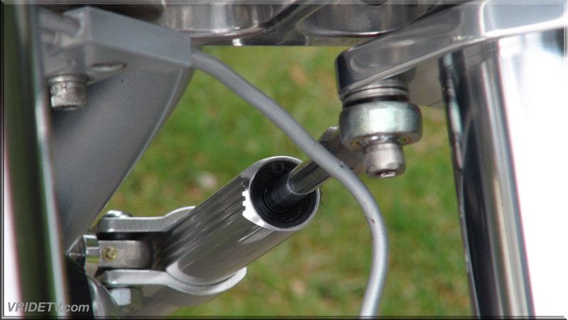

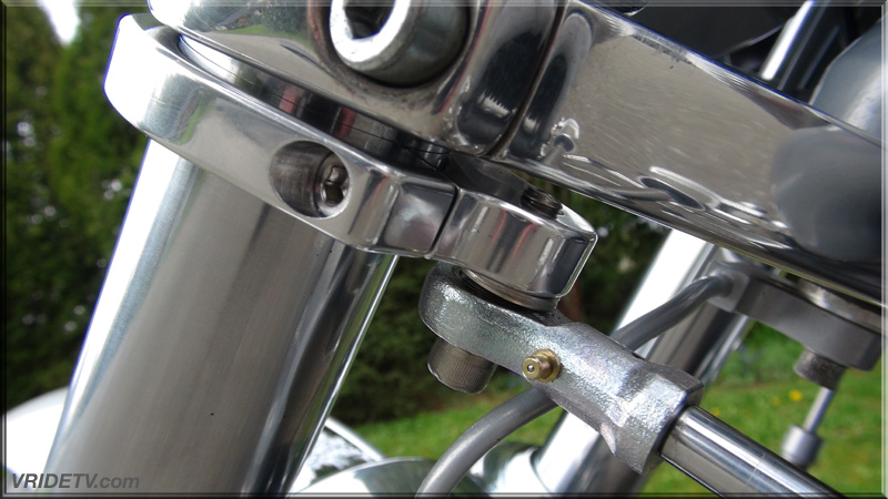

Thinking about your mystery spring. Those pips that the spring sits under wouldn't be grease nipple for the spherical bearing would they? If so there would be a ball at the top of it with the spring below to keep it sealed. When you broke through with the wire brush the ball would have flown off into oblivion.

You could be right about the grease nipple.This looks to be the make of my steering damper,a Pingel.You can see the grease nipple on it.Maybe it was ground down before I got it as I don't recall seeing a proper grease nipple on it before.
How hard are they to remove and replace?
Andrew
Andrew

A grease nipple it is, but there are a myriad of types, patterns and styles just to add to the fun.
Remove the existing (damaged) one (should just unscrew but will be a very fine metric thread), find one that fits your grease gun and the thread and bob's your auntie.
David

Thanks for the info on the grease nipple.It sure looks different to the one on mine but it could have been damaged by the wire wheel.I'll go to the engineers shop tomorrow and see if I can find a new one.Saying that though there was'nt a smear of grease inside it.

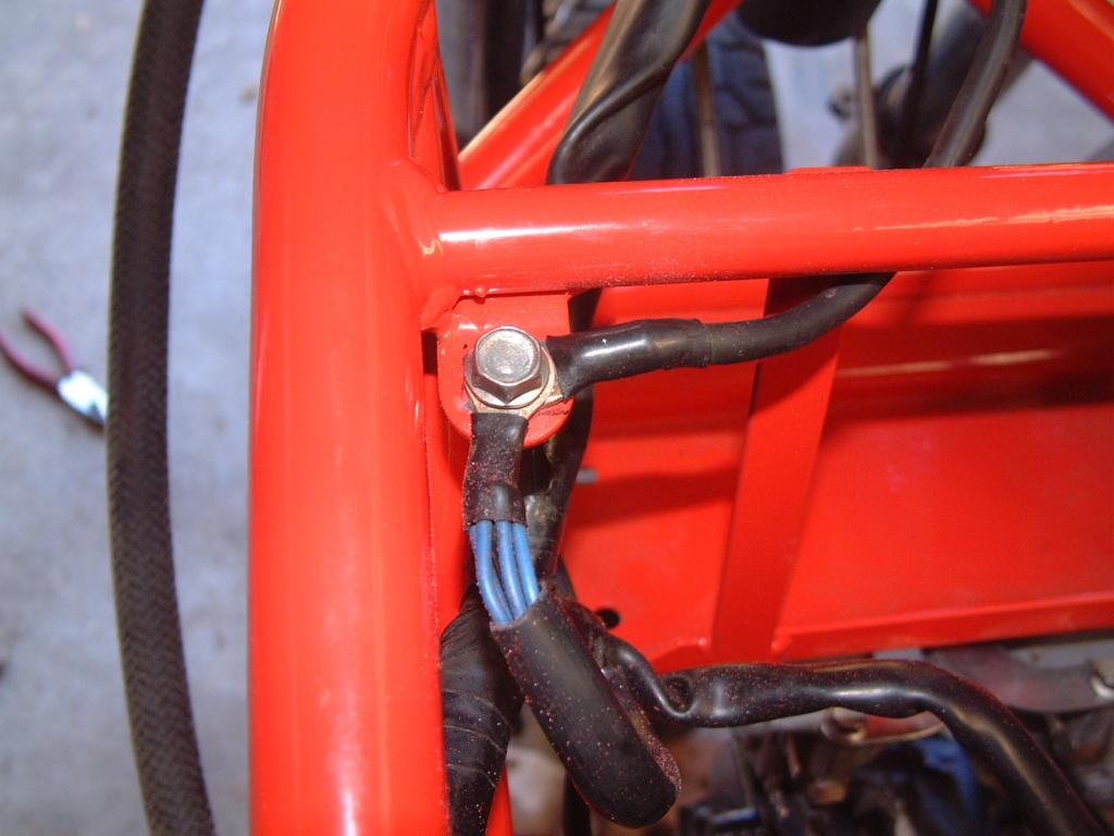

I ground a bit more paint away today for the other earth .

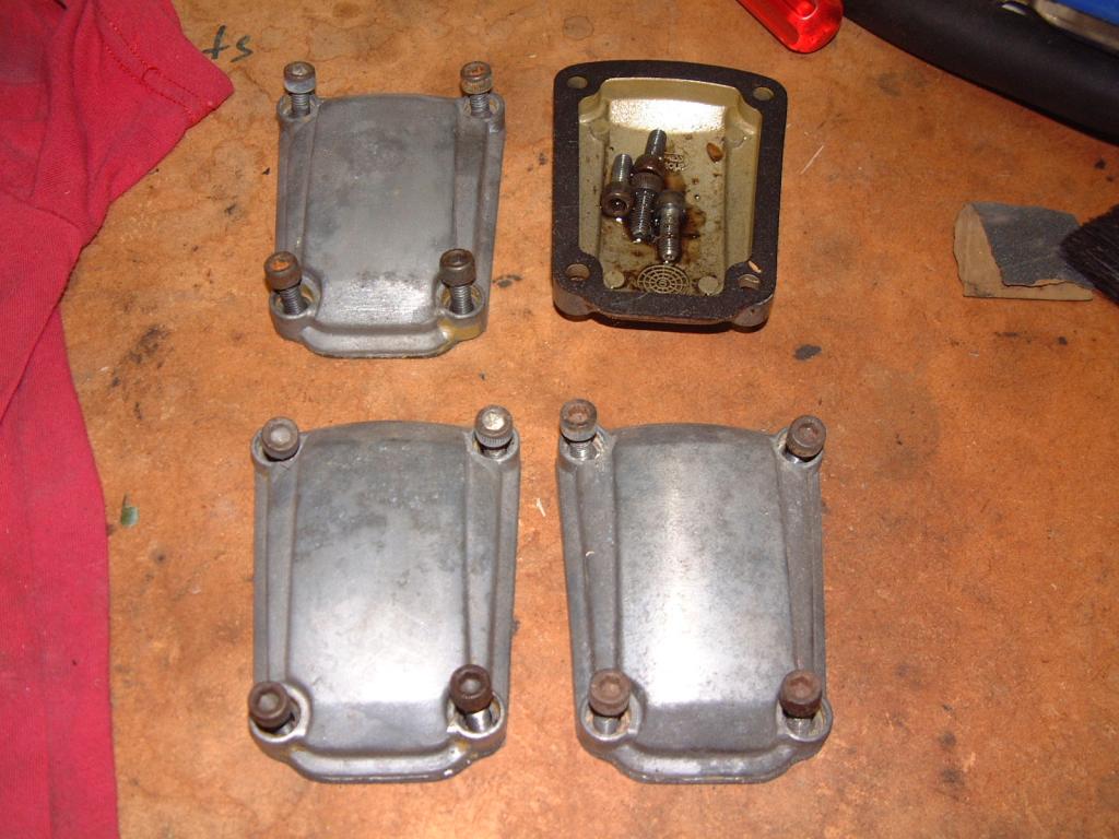

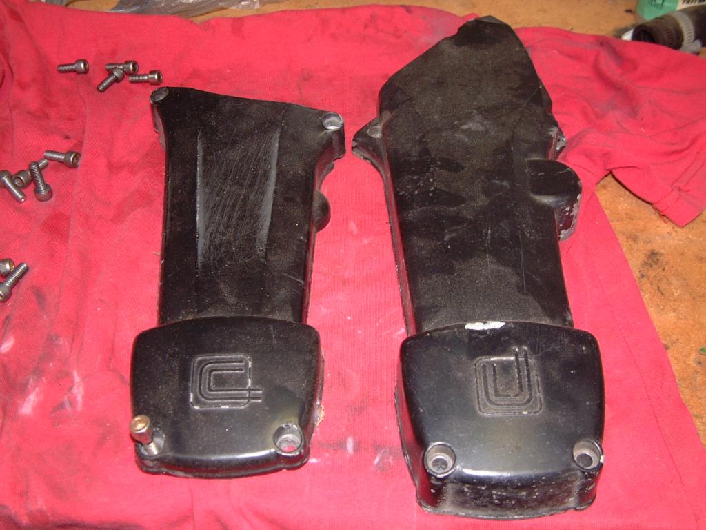

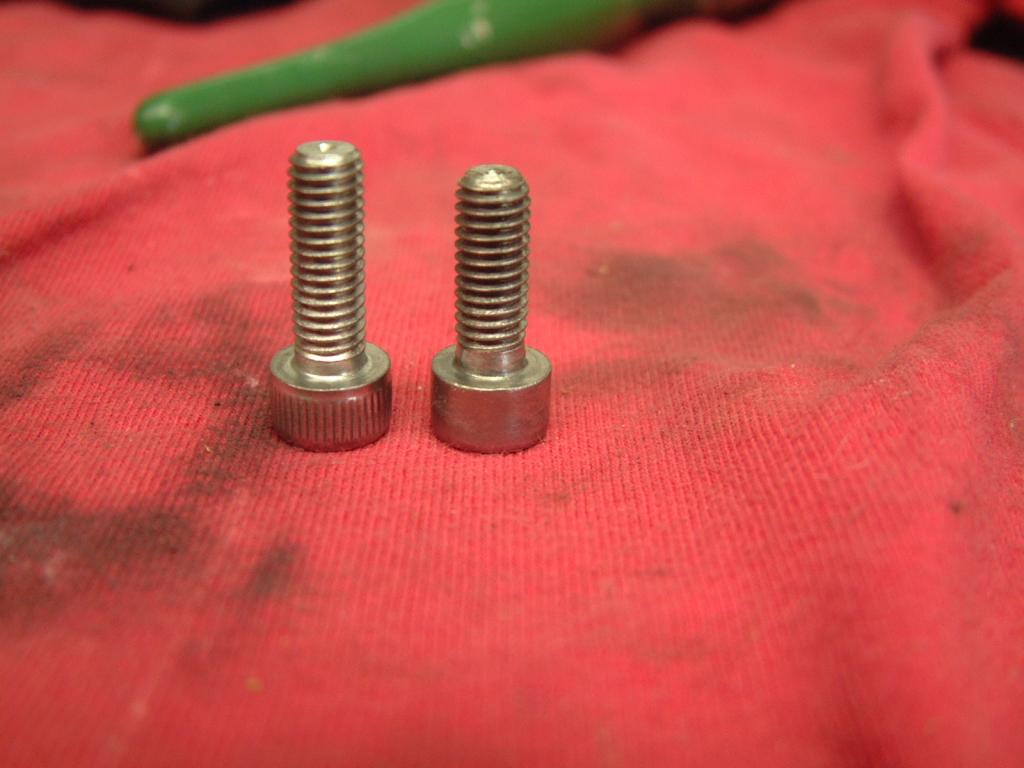

When cleaning the rocker covers I noticed the bolts for the front bottom cover were different from the other covers bolts.The odd one on the right.

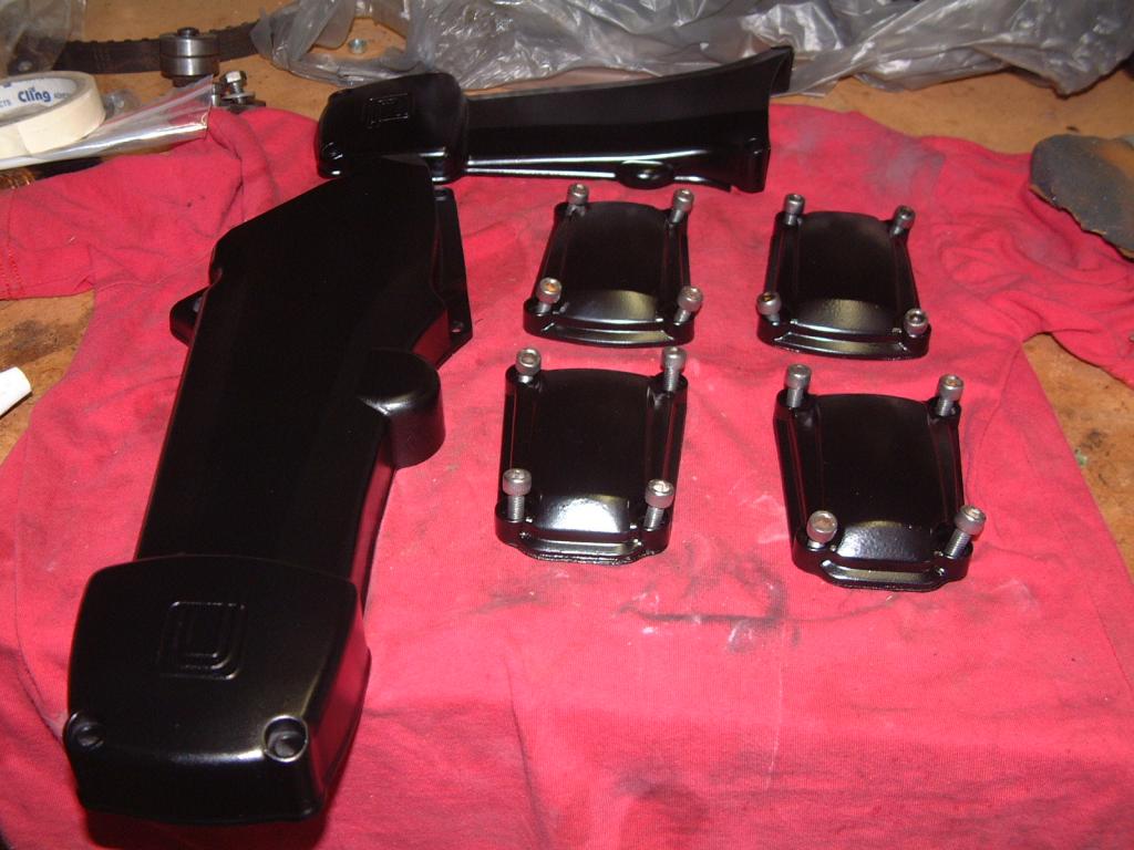

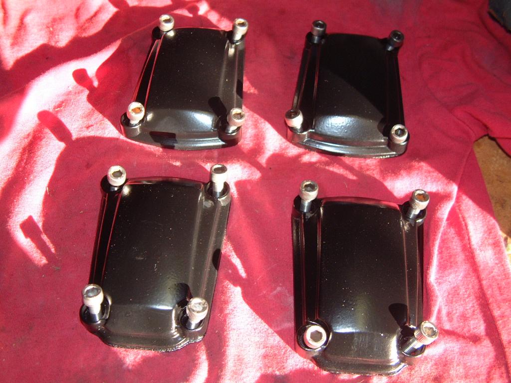

New paint on the covers..
...and the belt covers.

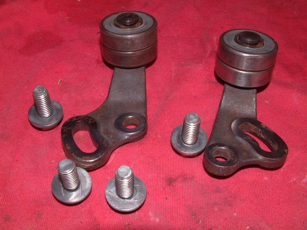

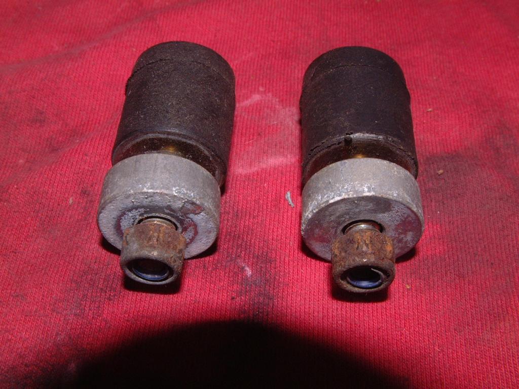

The timing belt adjusters needed a good cleanup.The belt covers were off the bike when I got it so most parts had some surface rust.I decided to just clean them and not repaint.
They spin freely so should be good.

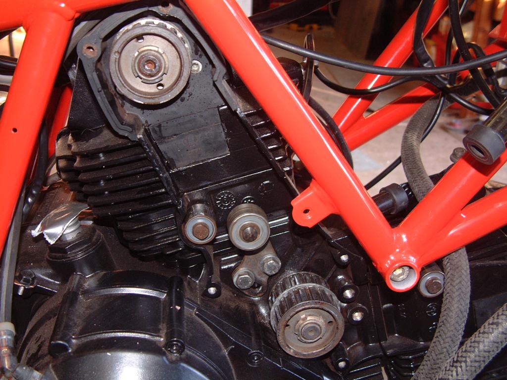

One in place.I've started cleaning up the timing pulleys as well with some rust converter and a wire brush on my Dremel.Hopefully I'll get these done tomorrow brfore the timing belts get here.
