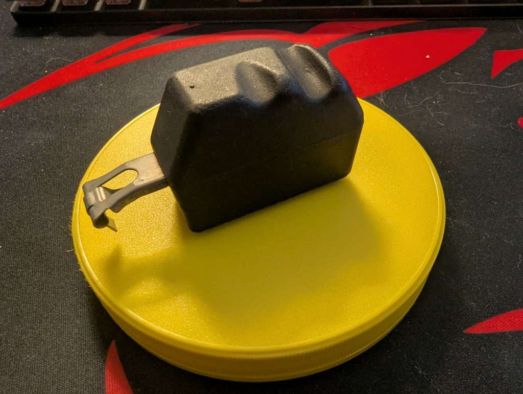

Is this correct float for paso carburator? In manuals i only find round float.

Mmmm I could only find round ones too . That float looks a bit special with the dimples .... possibly to clear jets in the bowl.

Yup, float looks the same from one of the two webers I have.
