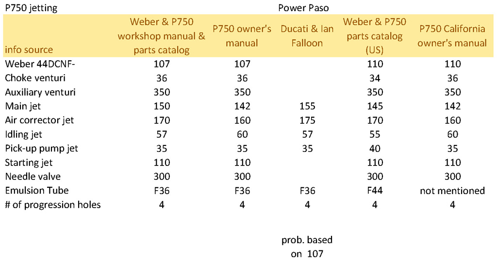

a big thx to Webcon UK and Classic Carbs UK for providing some info on the Weber 44DCNF-107 and -110 and to Frank for translating part numbers into jet sizes.
Here're exploded views of the two 44DCNF versions:
https://app.box.com/s/heep8qtaxti97872wqia6z7037bbhxv3
If anyone has a fiche or calibration sheet of the -110 (or files of any other 44DCNF version used on Ducs) please let me know!
Btw. the jetting mentioned in the wsm is not the same as in the owners manual. Also what's mentioned in the parts catalog as '(US)' does not fully correspond to the US or California version owner's manual.
