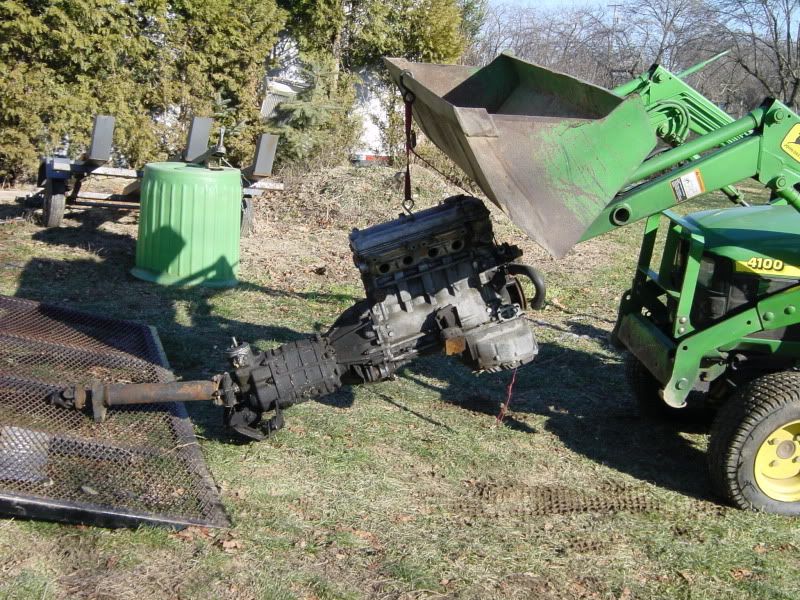

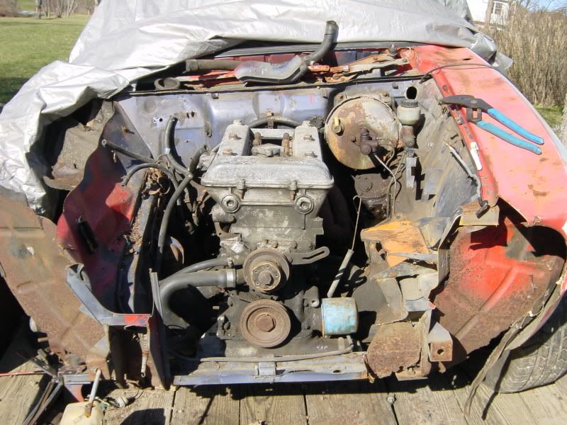

I have Mr. John Deere set up for plowing to push remove the snow. Here's a picture of us working on Friday to pull an engine out of an Alfa GTV:
Friday was 32 (0c) and sunny as you can see. Todaty and tomorrow a big storm is coming. :-( Time in the garage working on the other GTV.

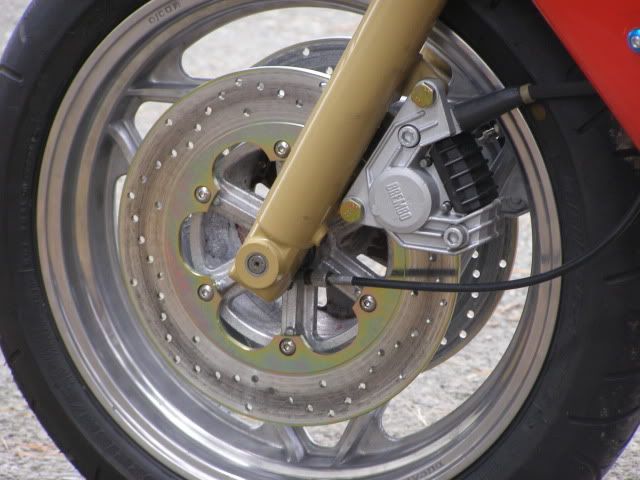

I bought these discs from here in Dec and they arrived in NZ in Jan. 116 euro each +34 euro for shipping. Exact Brembo replacement part but they are stainless vs the original cast iron. has a build date od 2005 stamped on them so they are not old stock from the '80s. Fitted and used as pics below. once the pads had scrubbed the plating off they started to work real well and by the end of the day i was quite impressed with stopping power. May hold off on the caliper upgrade for a while.

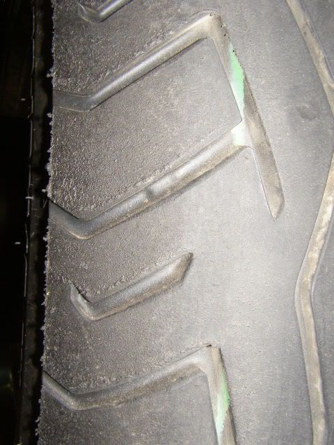

Hi
the bikes still has the 16" wheels. It's a Bridgestone BT014 on the front 130/70 which is a nice sport tire and works well. The rear is a 150/80 Bridgestone BT45 which is has been mentioned here on this site in the finding a suitable 16" rear tire saga. It is a crossply which also causes some to raise eyebrows!! But i have to say despite it being classified as a sport touring tire it worked very well at the track and never missed a beat. If you have a swing arm big enough to handle the 80 profile this to me is a great option rather than all the issues of trying to get 180 on the back. I pushed it quite hard so for road use it has to be good.

Clive...looking at that rear tyre, youre a much better rider than I am :thumbup:
...dont drop her! :beer:
