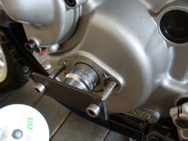

I would fit the bearing onto the crankshaft 1st , then fit the case , which should be just about a firm push fit
I made this simple tool to pull the cover off using a socket as a mandrel. The bearing should be exposed to engine oil so I would remove any seals on the bearing before fitting . :)
