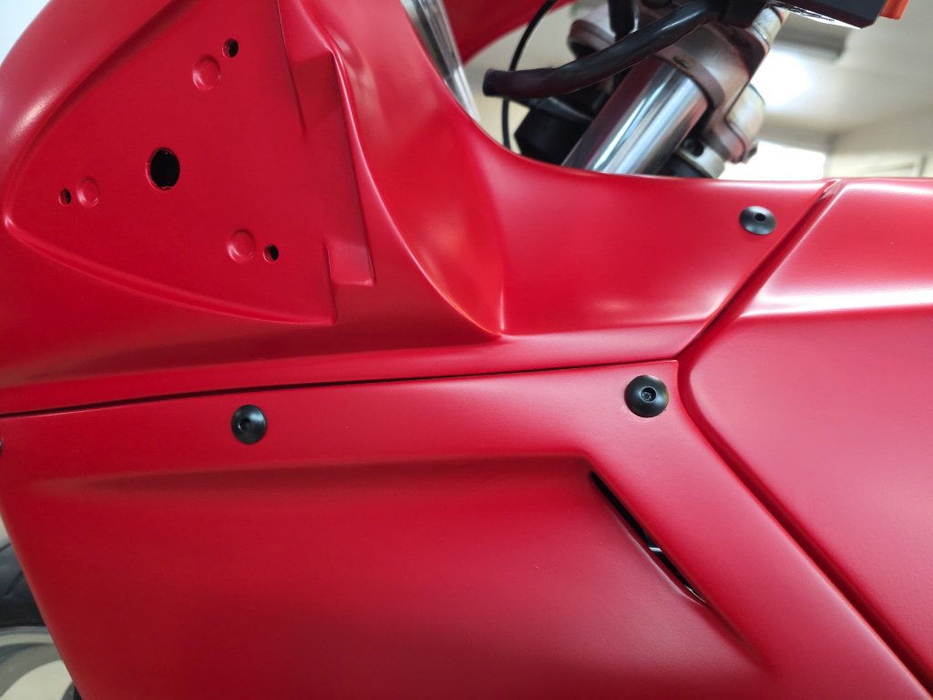

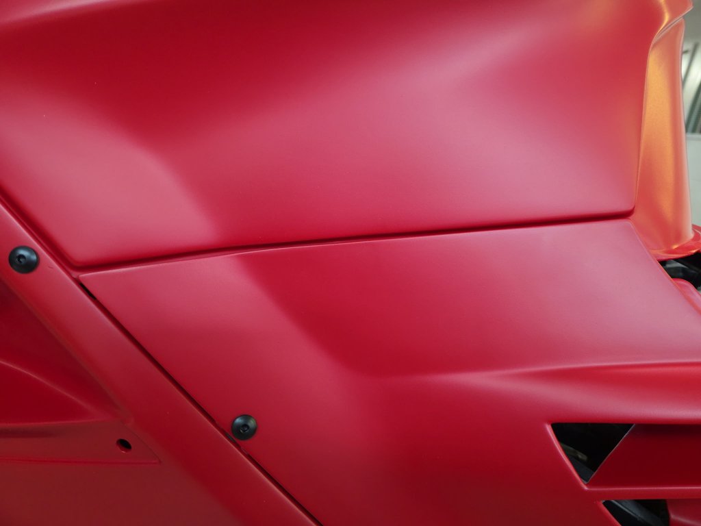

This winter I've been working to convert my Paso fairing to 1/4 turn fasteners. The well nuts offer some alignment flexibility and the new fasteners have less. There was always some weird panel fitment and the opening around the headlight never seemed right.
Yesterday I was looking at how the tank sat on the bike and found some interesting welds around the "tower" under the tank that locates it near the steering head. I'd noticed the paint and primer before but didn't look that closely.
There are a couple of odd touch up spots on one of the fairing panels and the front fender. I thought it'd maybe had a tip over or something. Now I think it took a hit on the tank at some point. Frame looks ok, as does the headlight subframe.

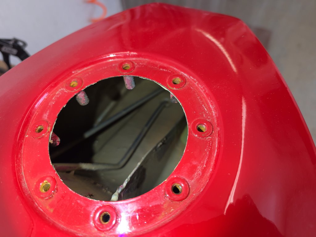

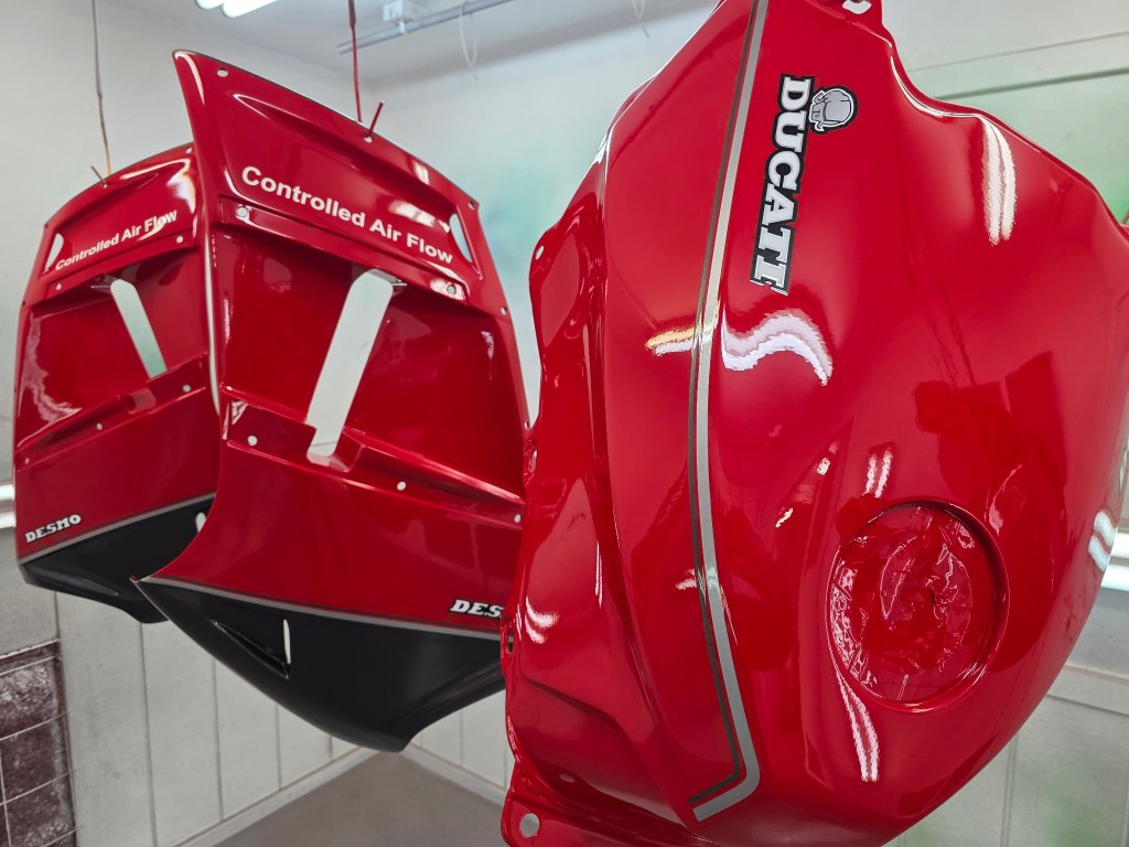

At long last an update on the Paso and tank.
I picked up one of those "NOS" 750 tanks that are floating around on the internet. Upon arrival I noticed that the petcock fitting is on the wrong side and the fuel filler is the larger later style.
Since it fit properly on the bike and aligned with the body panels we decided to relocate the petcock to the correct side and then cut the filler out of my original tank and weld it into the new tank.
Many months passed getting that work done and getting into the schedule of the painter. That said, it should be ready for me to pick up next week.

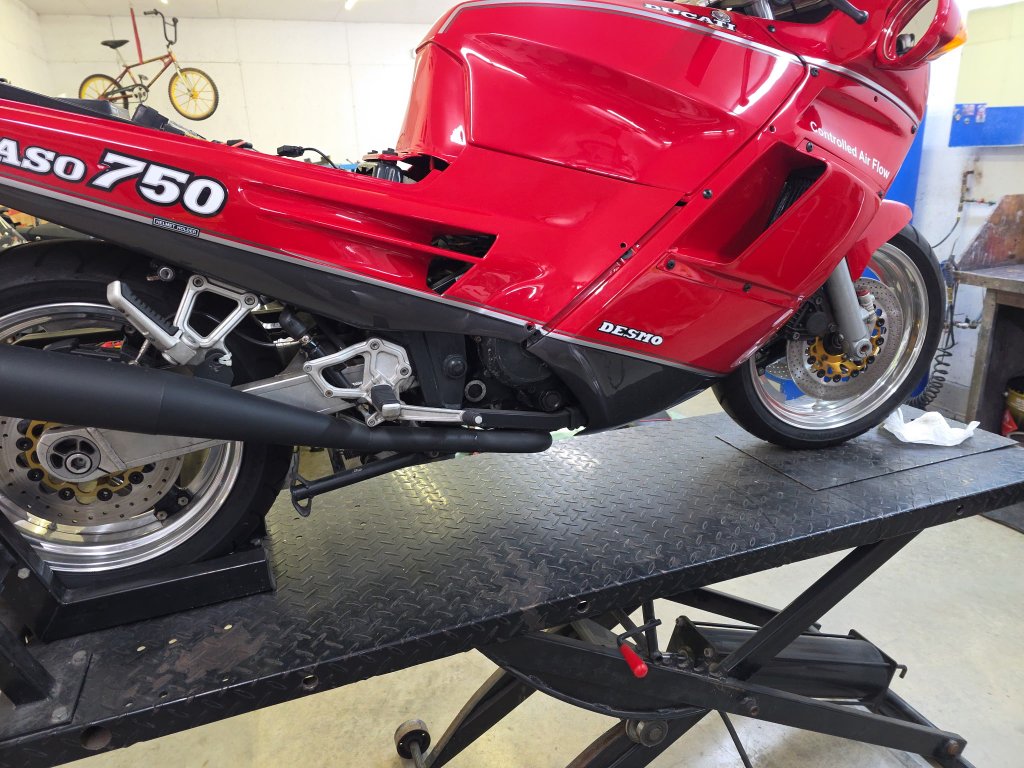

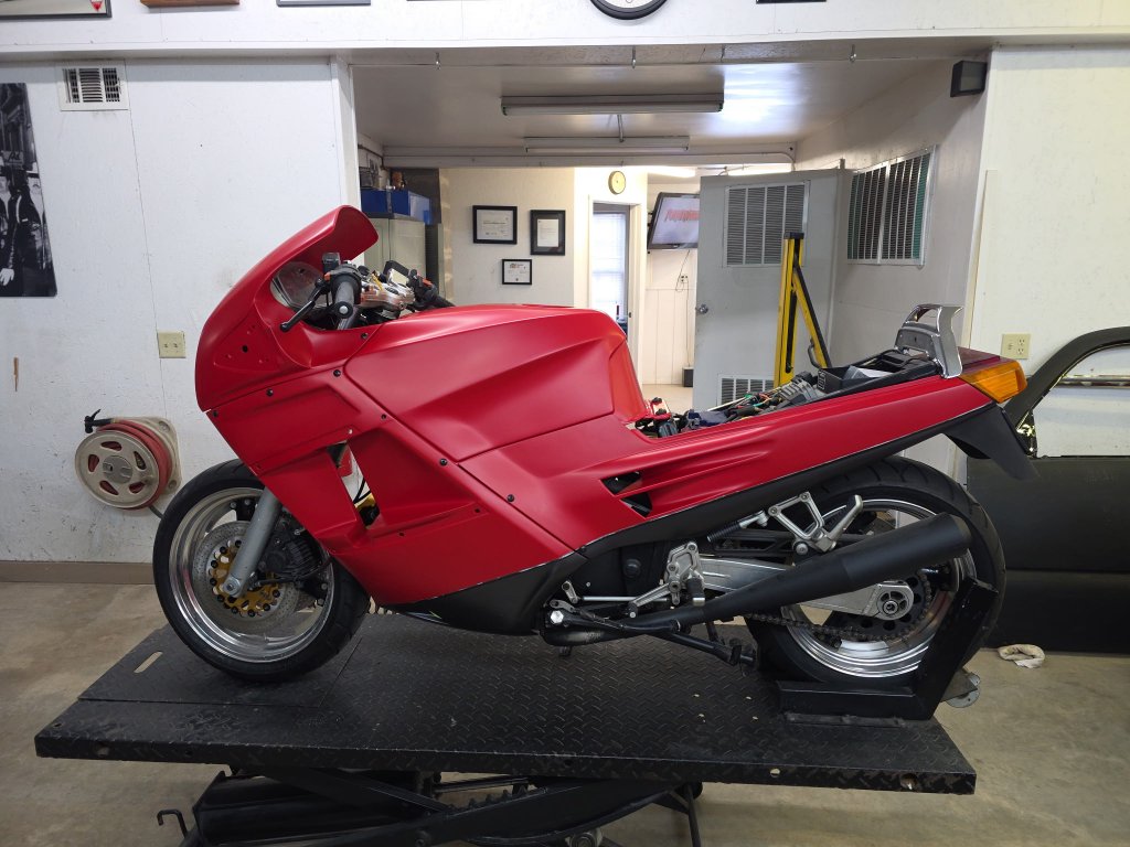

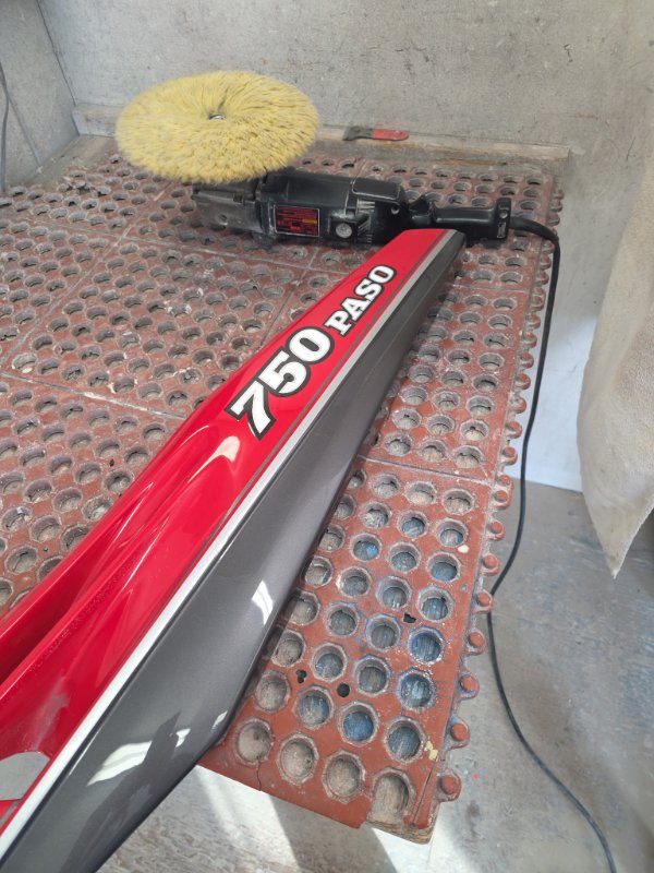

- oilyrover
- Posts: 40
- Joined: Tue Sep 11, 2018 3:33 pm
- Location: Boston, MA. USA
Re: Fuel tank fitment
Almost done. That's in clear but before wet sand and buff.
He takes a while but does gorgeous work.

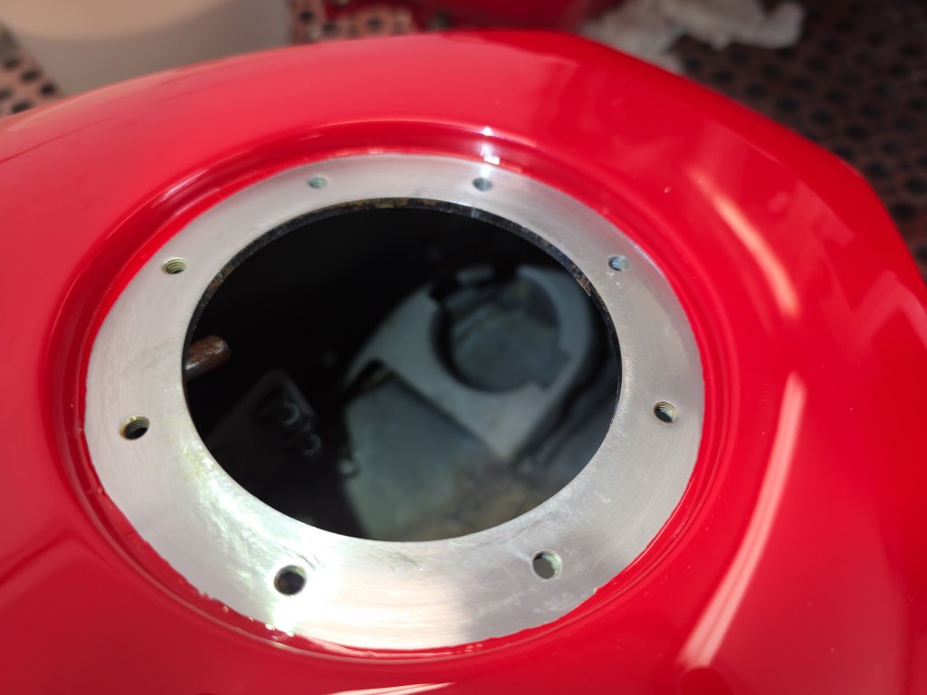

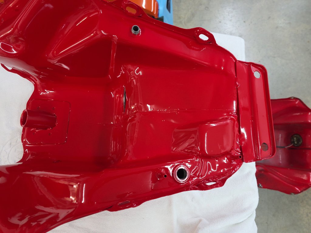

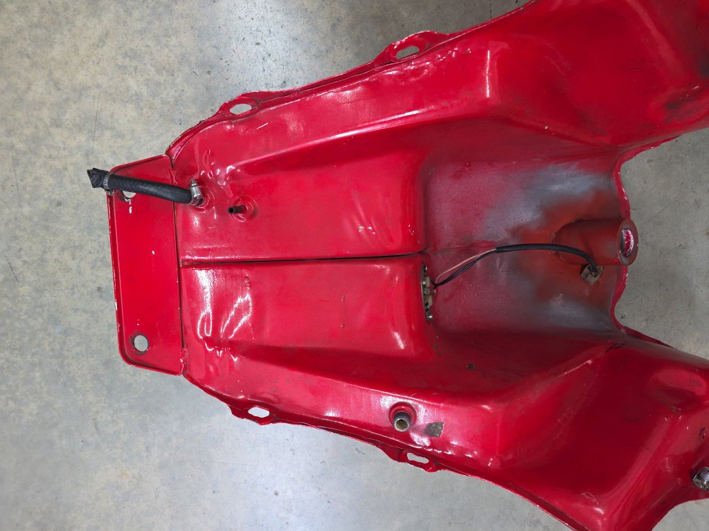

for reference, here are pictures of both tanks. and a correction, the fabricator had a new insert laser cut to take the stock filler assembly and welded it into the new tank.

- Posts: 5570
Nice job!
Is the freshly painted tank the "NOS" 750 tanks? Asking because that is a 907IE tank, which is why the connections are different and there's a bracket for the electric fuel pump inside.
The seat lock is upside down.
