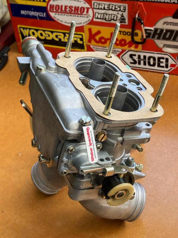

Hey Pete, I had a weber specialist overhaul my carb but it's still fluffy and hesitant getting back on the gas coming out of a corner. They suggested increasing the size of the pump jet but it turned out the previous owner had already done that tricks so I actually decreased it to a .35 (I think .25 is stock), but it didnt help. I'm assuming they set my float height to the stock setting, but I have not checked it. I will get back to this issue latter on when I get the bike mobile again. I want to stick with the stock carb too esp as I spent $700 getting it reconditioned!

Mc tool wrote: ↑Sun Sep 14, 2025 9:29 pm 700 bucks ! far canal ! did he gold plate it ?
No but he did bead blast it! :wink:
Theres was heaps wrong with it, a lot of bits replaced and time spent on it. It came back looking like new.
Hey what site were you looking at the Chinese FCR's on? Is there room between the cylinders for two carbs? I know the F1 has the rear cylinder carb on the opposite (rear) side.
Posts: 2033
Re: Weber Carb settings
Ali express and Temu .
Bead blasting ? , did they come up OK , just that I have bought a pair of Delorto PHF36's for my Guzzi and they do need some attention cosmetic wise but I didnt want to polish them . I thought maybe soda blasting .

Mc tool wrote: ↑Mon Sep 15, 2025 7:29 pm Ali express and Temu .
Possibly soda blasting, couldnt be sure, but looks good
Posts: 2033
That does look good :)
