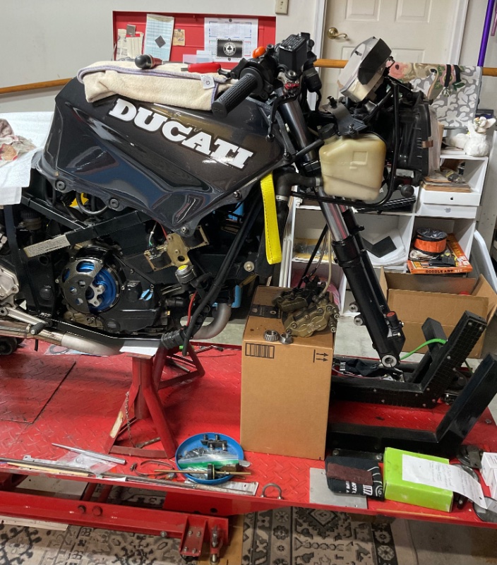

If you have a way to pull from above, if you have an open ceiling, I use a hoist and a strap run thru the steering neck to lift the front up. The bike would be on the center stand for a tire change. Any more extensive work and I put jack stands under each frame rail, see attached pic.
