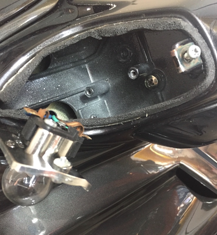

On a short ride yesterday I noticed the LH mirror had a lot of movement and I came across this topic along with many others on our lovely machines while researching how to tackle the fix.
As I am new to the Paso line I am devouring the great repository here, and where gaps exist on details I’ll work to add to the information.
Today I dug into the loose mirror situation and have some pictures from my work to help the next person with some insight.
To get to the single screw previous people have mentioned the turn signal lens gets removed and the bulb holder is loosened and moved out of the way.
Now you can see the single Phillips head screw just below the post for the bulb holder. As this screw gets loosened the mirror holder will start the walk out of its recess, keep a hand or rag over the mirror side so it doesn’t drop to the floor and go all Humpty Dumpty on you.

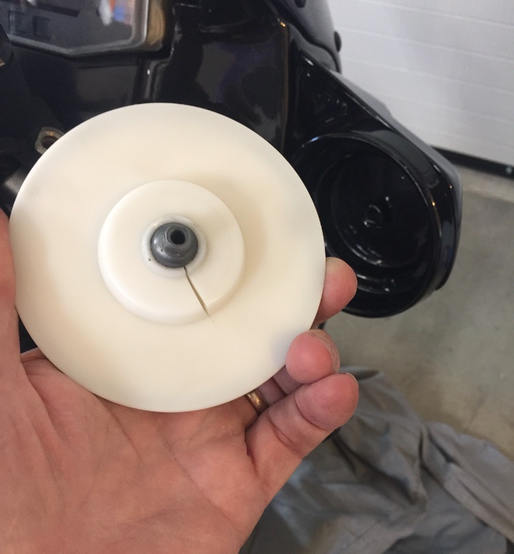

Now you see what the mirror holder looks like, and the ball & socket that Derek (previous posts) had trouble with. Mine was also reluctant to move at all. Some thin lubricant and gradually working the ball post got it free. Thread the mounting screw back in if you grab the post with pliers. The ball/post is die cast metal and as tight as I had to grip it, I feared cracking it or deforming it so I reinserted the screw. While I was at it, I figured I might as well take a look at the other side. Well, I didn’t expect that. The ball is still snug and the holder has a good grip on the ball, even with that crack. Actually I prefer this grip level over the LH one. This RH one has enough resistance to stay in position, yet to move the mirror doesn’t require excessive force. The LH one, I have to press on it so hard it feels like something is going to break to get to move.
I have them both adjusted to my liking, so they should not have to be disturbed.
