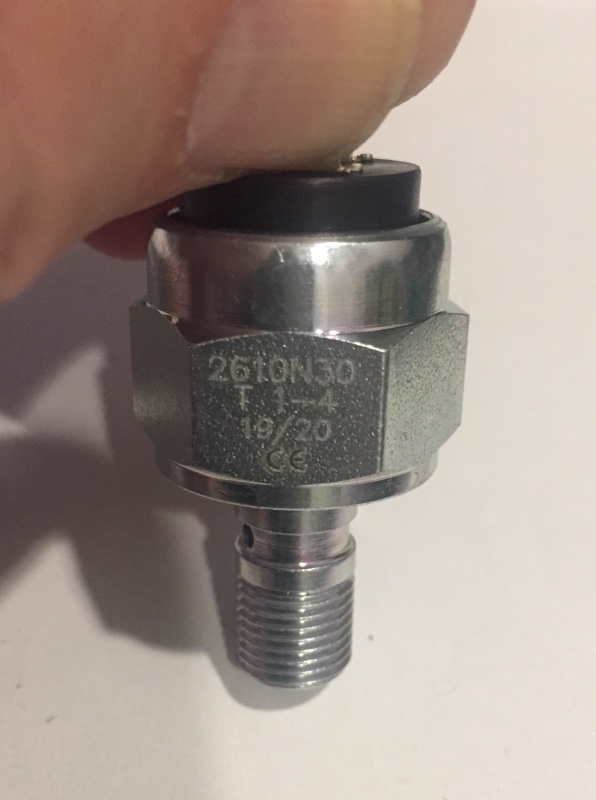

Some info on the rear brake light switch. As member Derek mentioned previously MDINAITALIA.co.uk has them available. I received and installed this switch from them last week. A couple of new washers, system bleed and I was good to go.
