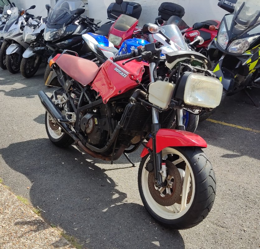

After 12 years at the back of the garage. Had it for nearly 25 years, toured France on it, only failed the MOT today on the rear brake light switch. I can fix that. What I can't find anywhere is a full set of 906 Paso fairing fasteners, Allen bolts and the captive rubber bits. Also rubber seals for the indicators. Any help/pointers gratefully received.

The rubber captive nuts are called wellnuts, try and get ones not made in china as the rubber breaks down, Rawl used to sell them as problem wall fixings in UK. I used M6 flanged stainless allen bolts and spacers were turned from a spare length of nylon bar
