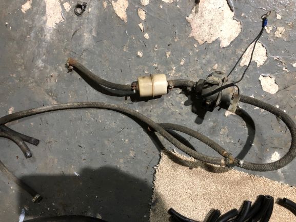

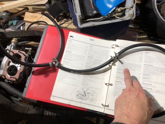

Hi Paso750. Many thanks for the info. My fuel line also has a T piece in it. Also, I would like to know if the fuel filter runs on the inside of the fram or the outside? Please see attached pictures. One of a complete line set from a Paso I just stripped, the other showing the new lines I made up with the T piece. Any advice appreciated.

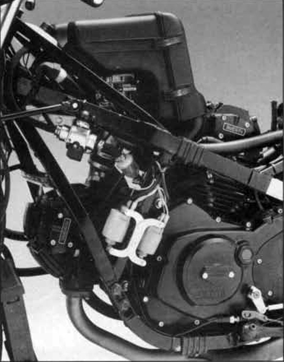

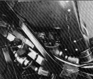

The reason you can't upload pictures may be that they are too big.
Here two pictures taken from old magazine articles.

Hi 750 Paso. That is great. I can now see which location the filter runs. Any idea on the T?

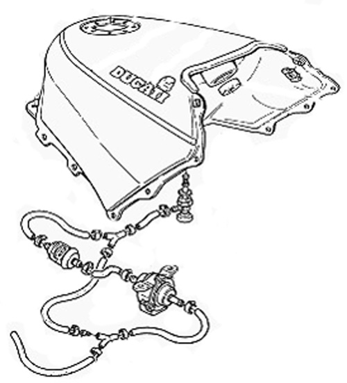

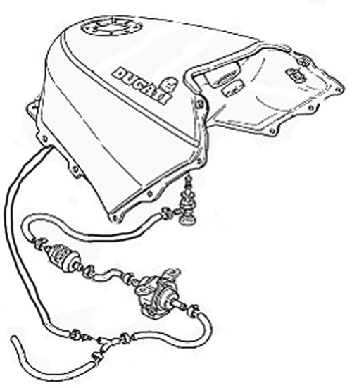

Re: Paso 750 fuel line run
The position of the T makes no sense to me.
There are 2 possible fuel line setups. The first one below is the one you have in your first picture. That is if your tank has a fuel return connection.
The second is if the tank has no fuel return connection. Then the fuel is sent into a loop instead to reduce pressure.
Note that in the Y-piece there's a Dell Orto jet as reduction piece. As in the pictures that should be in the exit to the tank/loop. Btw the fuel petcock shows forward not to the right side as shown in the drawings.
