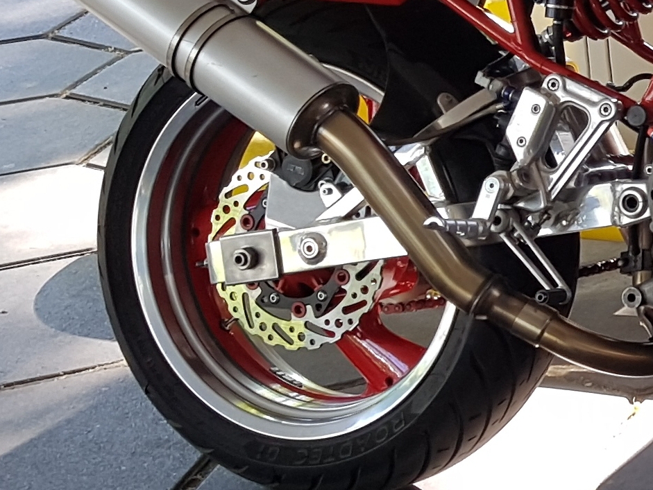

After quite some search throughout the web I finally ended up with a BrakeTech disc.
I was looking for a floating rotor.
https://braketech.com/axis-rear-floaters-2/
Re: Rear brake disc alternative
From what I understood Michael has the old brake disc on his new rear rim. The brake disc bolt pattern of the 16" and 17" rims is different so the BrakeTech one won't fit.
Looks nice tho. All the rest does, too :thumbup:
Post by MatthiB »
Thanks!
I'm not so familiar with the older 16" wheels.
I thought all 17" are mostly the same, except for axle diameter maybe.
Post by micap »
Paso750 is right. I have had some custom 17 inch wheels made, and as it is now I am using the original rear brake disc. I was just wondering if I could find a disc that would match the newer type brembo discs. But if seems to be a bit difficult. Luckily, the rims are made with bolt-on brake disc adapters, but it will be quite expensive if I I need to have a new disc adapter machined.
