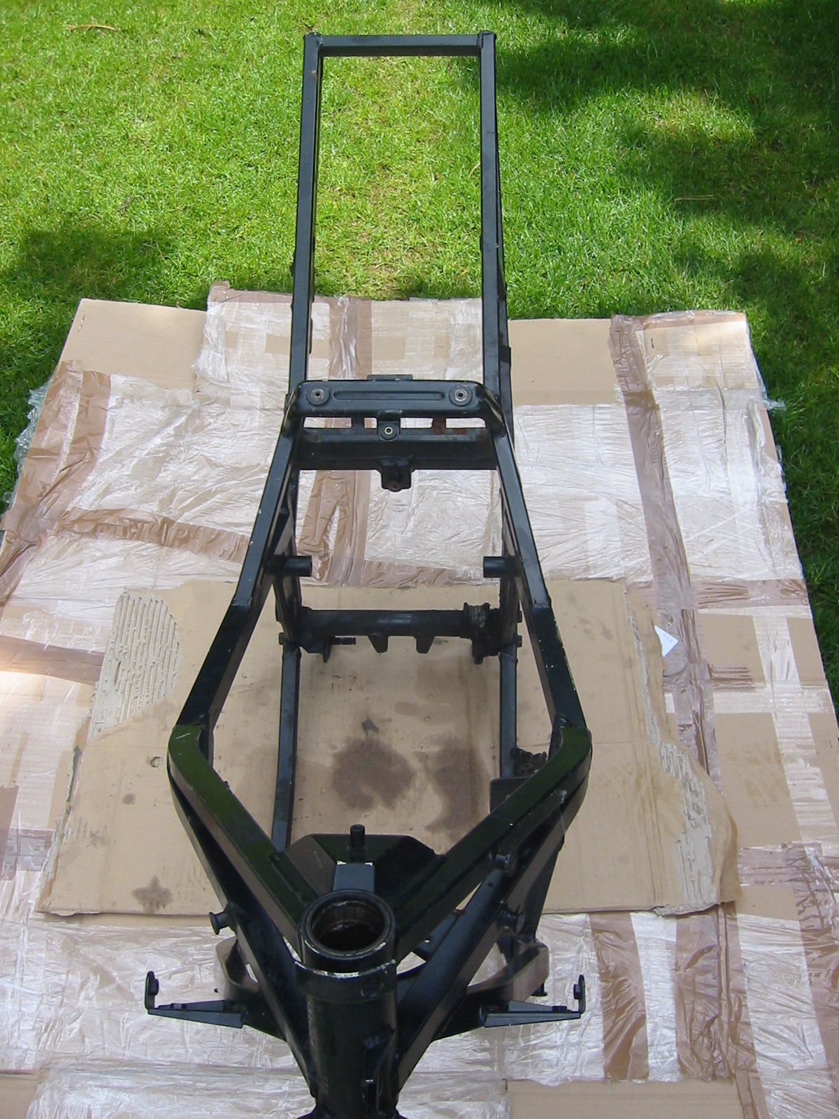

I have fitted a 906 engine in my 750 frame I'm now trying to mount the radiator, I can't find pictures of the radiator mounting brackets, there seems to be a lot of pictures in photo bucket that I can't view. Is there any way I can search or view these old photos?

Thanks Hamish. Some pictures would be greatly appreciated, I have 906 front sub frame I think brackets line up with that but conformation would be good.

Re: 906 Transplant
there's a 906 frame on ebay and there are numerous pictures. I've attached them.

Well that's better than anything I could manage
Re: 906 Transplant
Sweet. Thanks for that.
The brackets are higher up the frame than I was going to mount them.
