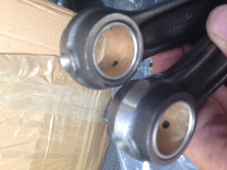

The Paua Poacher
- Posts: 69
- Joined: Fri Jan 24, 2014 9:00 am
- model: 900 SS
- Location: New Zealand
Re: 1990 900SS Small End
The small end is Nissan GA16/RB4107 19x22
Here's what they did (I made sure Staked to be sure)
REMOVE CON-RODS FROM CRANK.
REMOVE 2 X LITTLE END BUSHES FROM CON-RODS. MEASURE NEW BUSHES,
FREEZE FIT NEW BUSHES TO CON-RODS, DRILL OIL HOLES, HONE BUSHES
TO SUIT GUDGEON PINS. CLEAN, ALIGN CON-RODS, FIT BIG END
BEARINGS TO CON-RODS, CHECK CLEARANCE IN SPEC. & REMOVE BEARINGS.
BALANCE 2 X PISTONS, 2 X CON-RODS, SET UP BOB WEIGHTS, BALANCE
CRANK 52%, POLISH CRANK.
REMOVE OIL PLUGS FROM CRANK, ACID TANK CLEAN CRANK.
FINAL CLEAN CRANK, FIT OIL PLUGS, LOCKTITE STAKE OIL PLUGS, FIT
RODS TO CRANK.
RODS TO CRANK.
- Small End Bushes Replaced.JPG (29.63 KiB) Viewed 12318 times
