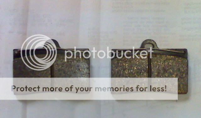

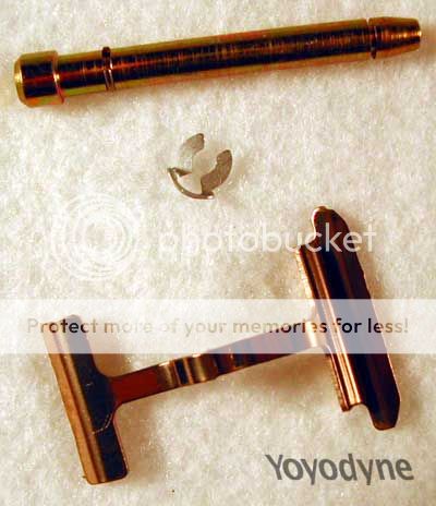

Projectman,
I would just buy whatever after market pad I liked, not worrying about getting the ones with the anti-rattle spring like the OEM ones shown below, and get a set of the later model (900ss maybe) anti-rattle springs, also shown below. They will fit the calipers perfectly and that way you still have an anti-rattle spring and the number of brake pads you can choose from will multiply as not many pad makers have the "built-in" anti-rattle spring like OEM. Just a suggestion. I use them.
