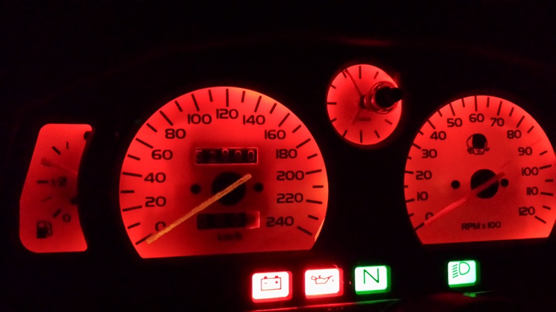

Hi guys, i've kept tinkering away at this and I can comment on the fluorescent paint idea. I repainted my needles (and clock) with red fluorescent paint (apparently it is gun sight paint). At a glance in daylight you can't tell that there is lumpy paint on there even though the close up picture it is quite clear.
Here's a night time pic... i've "charged" the speedo needle using the phone torch so you can see the effect. in real life it makes the needle glow and appear 3D above the instrument face - making it much more visible. compare the speedo versus the tacho needle to get the idea. it's much easier to see in real life than in the pictures (trust me).
and here is a pic with the dash off and you can clearly see the speedo needle glowing.
The problem is that while the needle charges up during the day fine (if exposed to the sun or other natural light) it only lasts an hour or so after the light goes away. So i'm toying with the idea of fitting a small UV light that comes on with the park lights and "charges" the needles.
