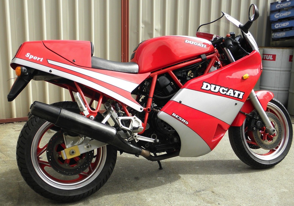

Hello,
After many years of lusting for a 750 Sport, I finally purchased one a few days ago. I'd like to spend some time going through it all and getting everything just right.
It's been delivered with new belts, motor oil and Michiko tyres. I've already replaced the fuel lines and looking to flush the brake and clutch fluids. I've noticed a squeaking sound from the clutch at idle while in neutral. The sound disappears when the clutch is dis engaged. Any ideas?
It's an original bike including webbers, pipes etc.
Thanks
D

Re: New Member 1988 750 Sport - squeaky clutch at idle
Hi and Welcome D.
I've heard and seen this particular bike running in the flesh so to speak, and it was making all the normal engine and dry clutch noise's you would expect, you just hear a bit more with the drilled clutch cover, it's nothing to be overly concerned with, and that is normal when the clutch is pulled in.
Peter
Hi Peter,
Thats good to hear and Bruce was a pleasure to deal with too. I've already downloaded the manual and been through quite a few posts…..great site!
This is my first belt drive so I'm getting up to speed and looking forward to knowing the bike better.
I inspected under the seat this morning and found the original tool kit and jets which were updated at some point.
Overall I'm impressed with the condition of this bike, very happy.
Just as a precaution,undo your dry clutch cover and put a light smear of grease on the pressure button. J.
- Posts: 5567
when you have the clutch cover off also check if the bearing in the clutch piston still turns smoothly.
Just thought I'd provide a quick update on the clutch for those who might be tinkering. The clutch still makes a little bit of noise which is normal from what I've been told.
The solution:
I pulled apart the slave cylinder and found the seal was corroded and started leaking…….how it didn't leak to being with is a mystery.
- Cleaned the plates and steels
- air blasted the the clutch basket and housing area
- fitted a new seal and lightly lubricated it with rubber grease (standard Ducati part $7 AU)
- cleaned the clutch cover, slave piston & spring and the oil channels
- fitted higher gauge clutch springs (stainless items from ebay $35AU)
- re bled the entire line with DOT 4 (leaning the bike to the one side with a block of wood into the frame……strange angle these MC's)
The clutch is nice and smooth now. Also, it no longer shudders when gearing down at higher rpm's thanks to the firmer springs. I suspect the clutch plates are stock too.
Nice to hear what you've done with the clutch Des.Do the heavier clutch springs make the pull on the lever any harder?.
Andrew
Hi Andrew,
There's no difference in terms of the clutch action resistance but it does have a smoother release when re engaging the clutch upon take off. I think it's important to clean the bore thoroughly before re assembly including a light emery paper allowing the o-ring to move freely. The bore spring and piston needed a good clean too.
The stainless springs apparently have 10% extra strength than stock. I don't have tooling to validate the facts but I could feel the difference testing by hand.
Overall it was a very cheap fix. I was doing the smaller items prior to looking at a new clutch stack.
