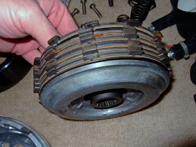

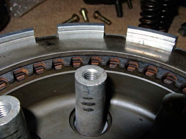

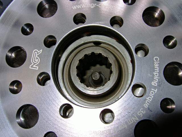

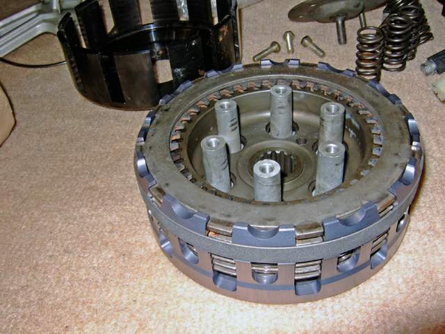

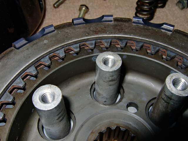

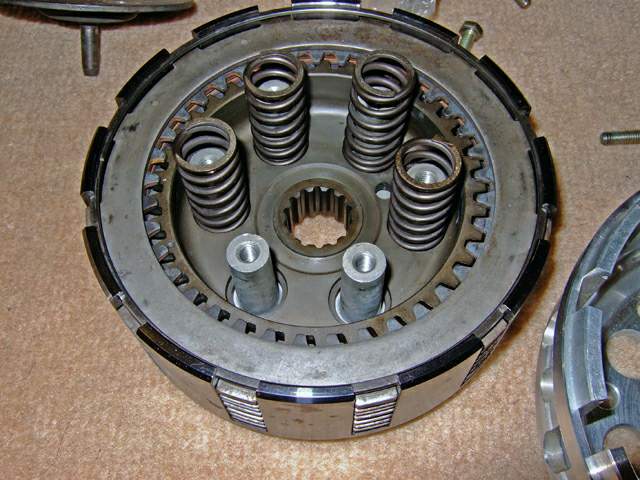

a few pictures
the original clutch

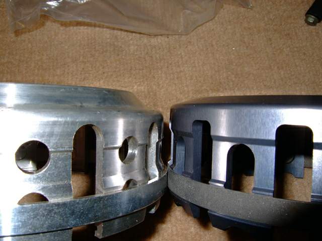

clutch basket for later model Ducs on top of the P750 one (same flange dimensions & mounting holes)
as far as the clutch discs go the dimensions are the same as well. (P750 clutch pack in other basket)
but
vs. original
the reason
The only difference is that the Paso clutch basket is 4mm deeper.
As other than that the baskets are identical I would assume it would be easy for a manufacturer of aftermarket Ducati clutches to design and make a basket fitting the Pantah engine but as with so many other parts the sales volumes were probably so low they wouldn`t have any interest.
I`d love a 48 tooth clutch basket :)

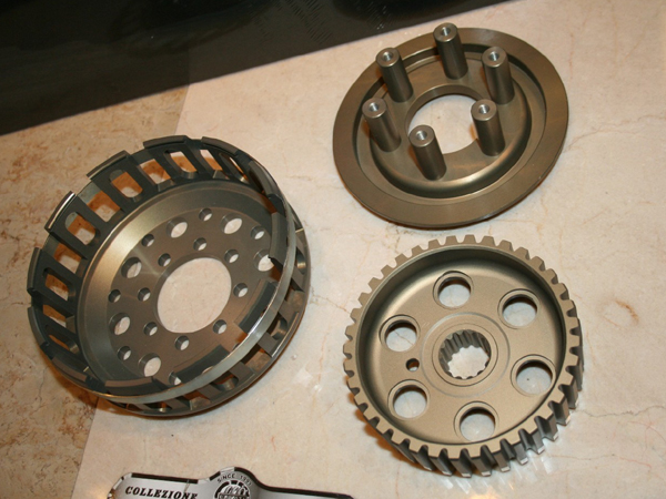

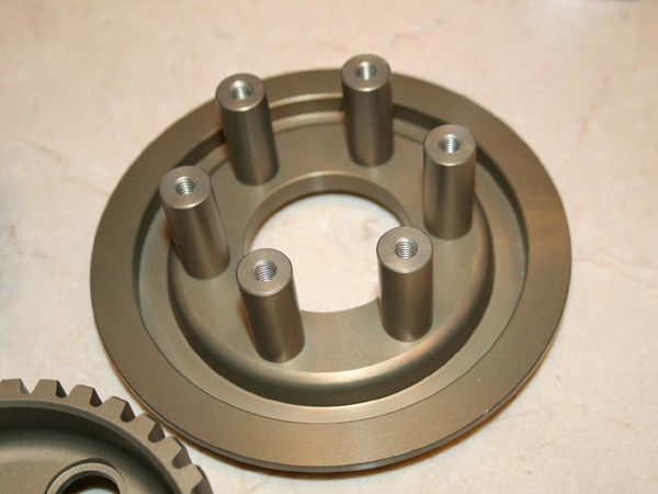

Posts: 5568
Re: Paso clutch (again) compatibility / aftermarket alternat

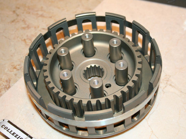

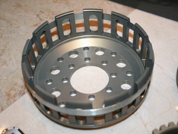

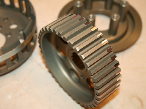

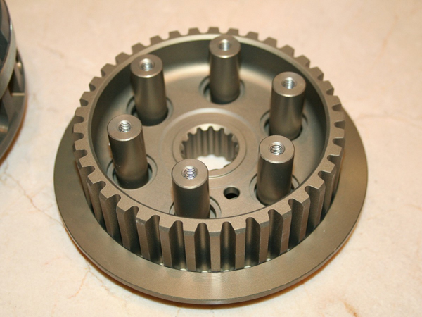

found some more pics of those race parts on a japanese website. They are nice.

there was a VeeTwoo clutch basket on ebay but you don`t read your pms ... Maybe you`ve seen it though.
The one Kaemna has is from TSS
http://www.slipperclutchs.com/?menu=news_2010

Posts: 5568
angelix
Posts: 338
Post by angelix »
Thanks G, those are very interesting.
I still need to find out if my drum's spline, in any event these baskets lookk nice although they are not lightened.
In the meantime I also got in touch with a UK company, Sigma performance, they have basket one on the shelf, but before I decide what to do I would really like to take mine off and see its condition.
