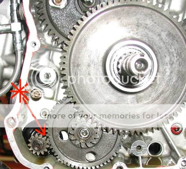

I have often wondered if the starter could be removed without first removing the left side engine cover.
Take a look at the photo below. Look at the plug that the red asterick is over. It can be removed from the front and then I wounder if the starter bolt can be reached and loosen/tighten by working through the hole after removing the plug? Has anyone tried this?

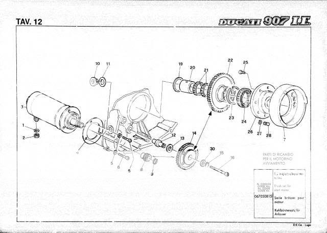

That would be removing plug #10 to get to screw #6 in the second picture.

Id like to watch you try :thumbup: , hang on and I will get a keg of beer and some groceries to keep me going while you work on it :P ,ha ha . Sure would be good to be able to do tho as removing covers is a pain

actually I don't think you could get enough turn on the allen key thru that gap to get to the next flat, 60degree turn?
